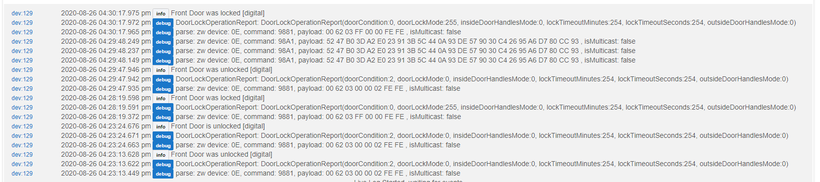

So I updated again. Initially the lock was functioning fine, I was about ready to report I had a false alarm. But now several hours later I am getting this delayed / no response to commands. Attempting a reboot now to see if it corrects it. - Which indeed seems to have straightened out for the time being.
It seems something definitely changed in the last update.

applied latest update (.142), resulted in re-occurrence. Rebooting didn't fix. But no excessive zwave traffic.
The thing that seems to fix it is the overnight maintenance...
Recurrence of general Z-wave issues, or lock-specific stuff. Wha-hoppen?

No Zwave busy. Locks wouldn’t respond. Neither would lights via Zwave. Did reboots but not shutdown and pull plug. Previously have done that when this happened right after 2.2.3. Can’t recall if it actually fixed.
Nightly maintenance seems to fix. Zwave has been perfect today.
