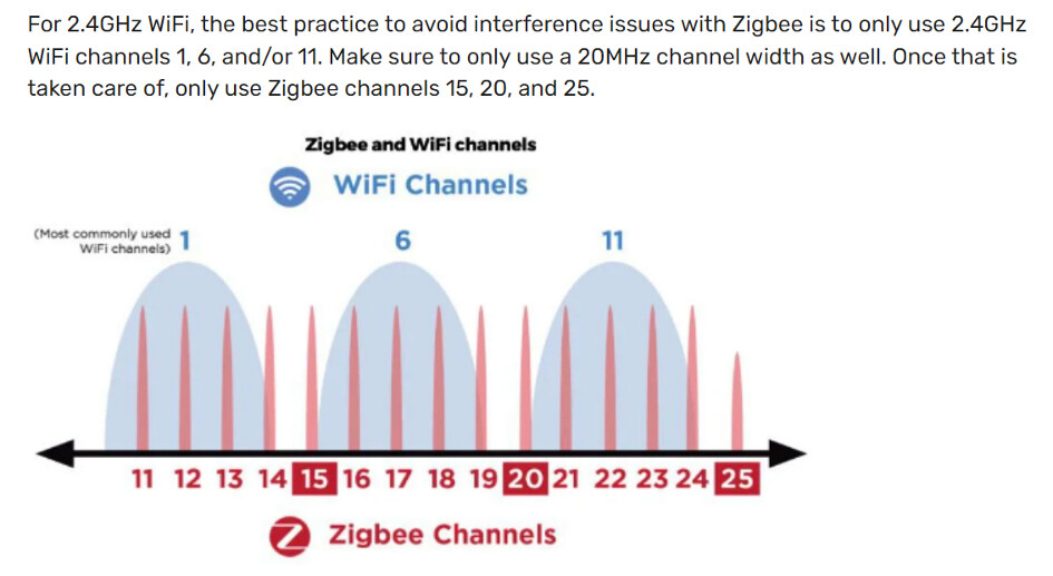

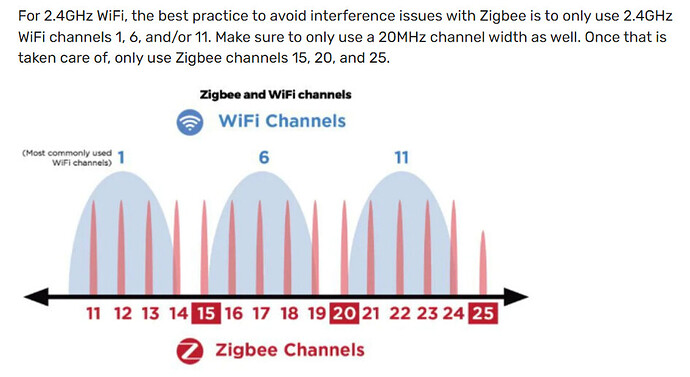

Per @sburke781's comment...you do want to avoide Zigbee/2.4ghz network interference. See image below. Generally keep Wi-Fi down towards 1 and 6, and Zigbee on 25 works for many of us. Each time you change channels it can take a while for all devices to find their way back to the hub on the new channel, and in some cases you may have to power them down/up, or possibly re-join.

Thank you everyone that posted replies. I'm planning on changing the zigbee channel to 15, 20 or 25. Wondering if anyone with a complex smart home has an opinion on the best channel and location for the hub with respect to the devices. For clarity, I have two streaming media devices that rely specifically on wifi and recently swapped the eero's for ASUS wifi mesh that incorporates a 2.4ghz iot_wifi network for certain wifi devices (still learning about that).

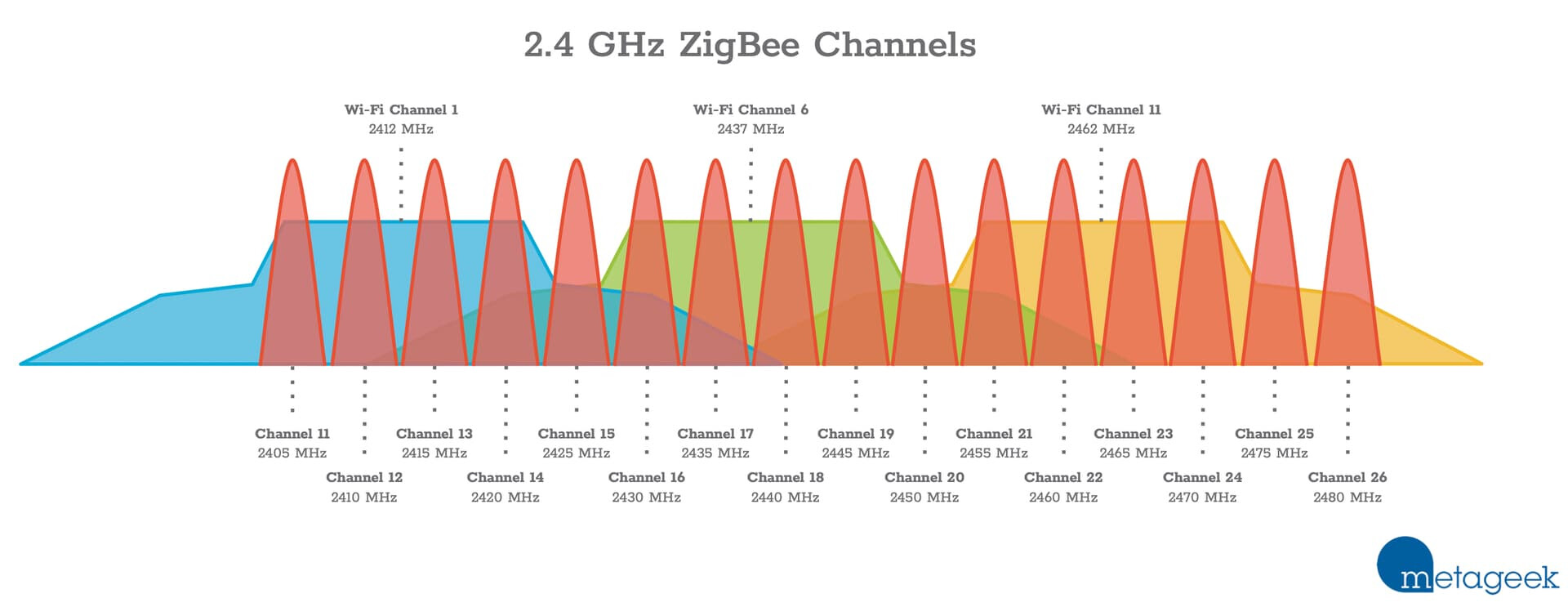

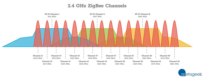

Zigbee channel selection depends on 2.4 wifi in use around you (yours and any nearby neighbors). And of course any other zigbee meshes you have (e.g. Hue).
All things being equal, Channel 25 has been a popular choice for many of us using C8/8Pro. Though my Eero adjusts channels automatically, its 2.4 wifi consistently stays in in the lower channels and my Hue's forever been on zigbee ch 20, so although zigbee ch 15 always worked great on my SmartThings and HE C7, it was problematic with my C8/8Pro -- moving my 8/8Pro over to ch 25 was been solid for me.
Zigbee Ch 26 is commonly avoided as not all devices support it and it's limited to lower transmission power in North America.
I have three Unifi Access Points (2 for the house and one in my buildings which the signal reaches the house slightly). The house wifi channels are 11 for the main AP and 6 for the secondary AP. The AP in the building is on channel 1. Run three different zigbee coordinators. Hubitat C8 Pro on channel 20 with power level 8 (out of box setting). Aqara M2 Hub on channel 15. Home Assistant using Z2M on channel 11. The HA channel 11 does fall in the same range as my building AP on channel 1 but the WiFi signal is so week in the house from that AP I have zero interference. I wanted to keep channel 25 open if at all possible in case I had any issues.
