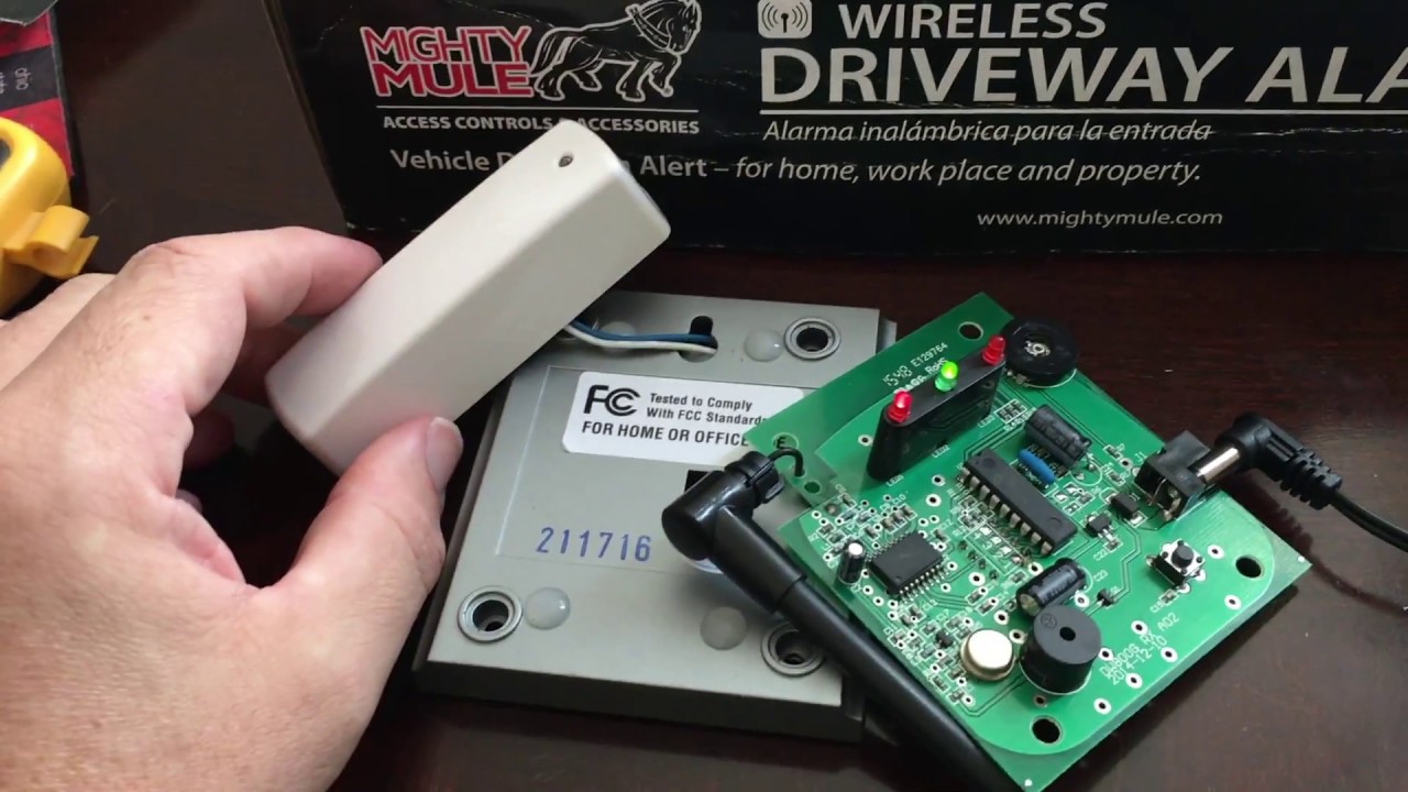

The sensor itself is battery operated, sending radio wave signals to the indoor alarm unit, which is powered by a wall plug. As best I can tell, the alarm unit primarily interprets signals showing activity and low battery from the outside unit. It doesn't on its own have any smart features. As covered in some of the topics involving the HubDuino, some users have managed to wire in the alarm station unit to give it integration with Hubitat. Though I admire the project, it's a bit beyond my own capability, and the end product looks like it could be a mess of wires unless you're very skilled at cobbling together this sort of thing.
I recently obtained a Flipper Zero. Using it's Sub GHz raw feature, it could record and imitate the specific signal sent by the driveway sensor when triggered. I've not hit a low battery yet, so it's unclear if a specific signal ping might be used to have the alarm unit show low battery or if the system detects some level of weakness in the signal to indicate low battery. Since the signal can be easily recognized though, this got me thinking, would it be possible to integrate the device with Hubitat using something that skips the Alarm unit entirely? Is there some sort of smart device that can be used to listen for and react to specific RF signals and be used to trigger actions on a Hubitat? Maybe something with a Raspberry Pi and the right RF dongle exists that could be tuned to such a purpose? I would think something like this might also be useful to bridge other devices that use distinct, but easy to recognize RF signal bursts.
