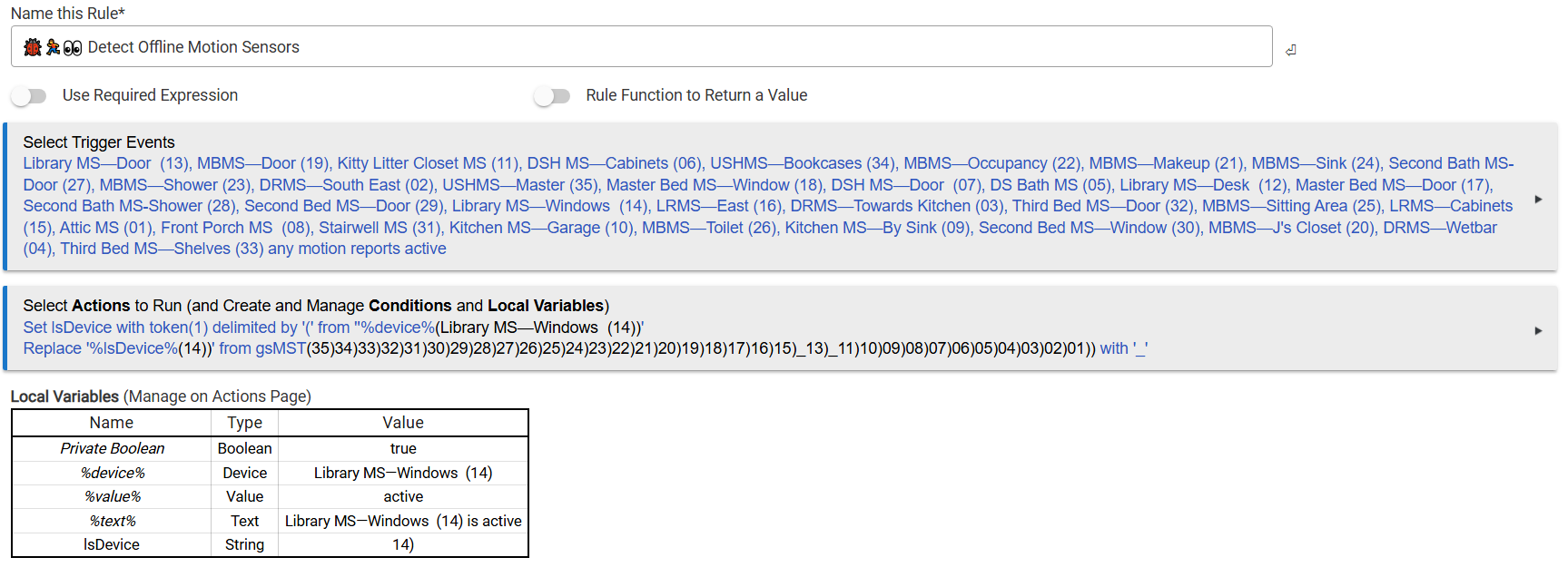

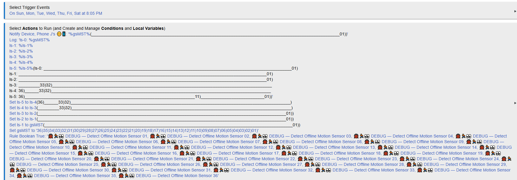

I also started brute forcing a tracking app. It was a pain in the ■■■, but I stumbled upon the string token functionality that made it pretty easy (what I was looking for in my original post). What I did, for others who come upon this problem, was to number my sensors names with (01), (02) etc. at the end. Then I have one app that pulls out the number from a string with all the numbers and replaces the number with "_" when the sensor triggers. At the end of the day, I report what sensors did not trigger. If I see a number that I expected to be triggered, I know it's fallen off the network. The tracking app looks as so:

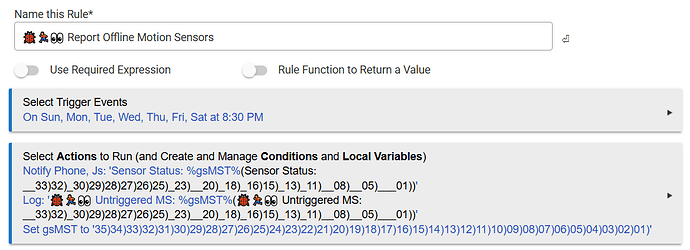

The report app looks as so:

So, I finally got what I wanted (took a while, because I'm not the brightest). Posting, just in case someone is following my breadcrumbs.

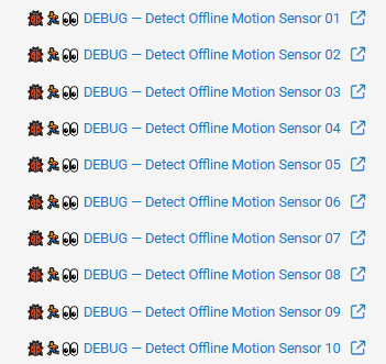

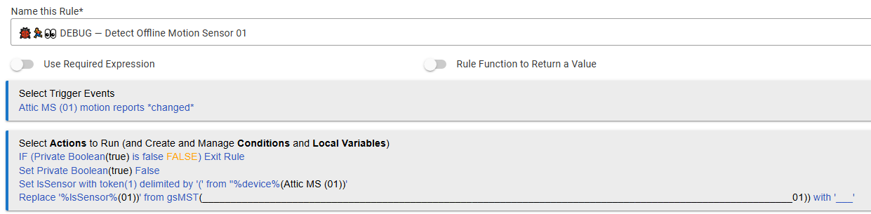

The key was seeing other people use the local boolean to make the apps "one shot." Specifically, I set up 36 tasks:
Each one only fires once a day:
The token delimiter and string replace allowed me to clone one task 36 times without going in and changing the code.

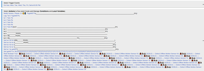

Then at 8 o'clock every day I get a report and reset the local booleans:

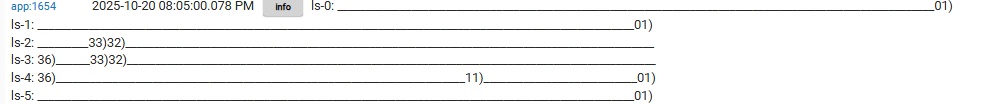

I also keep the last 5 days information, so I can see if there's a trend in one sensor that is stuck:
Anyway, this has been perfect to minimally intrude while detecting if a sensor has gone offline.
