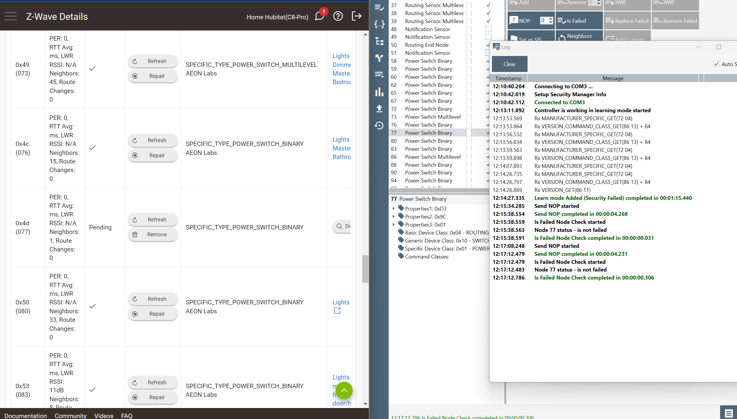

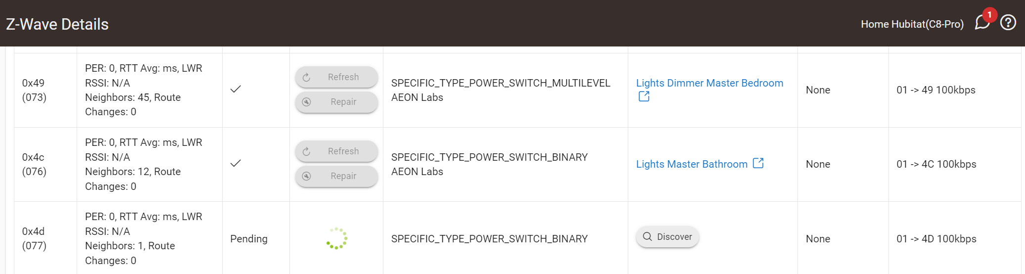

I have recently purchased a C8 pro and in the old c8 hub has been moved to cover zwave device on the second floor. I have attempted to remove a aeotec nano switch from the c8 pro (locate on the ground floor) but it will not remove.I have tried the following:
remove power to all zwave devices then attempt the below
Refresh/remove many times from hub zwave tools
added zwave usb and set to "isfailed" (see screenshots, using zwave controller)
shutdown hub and remove power for 1 min the attempt the above again
Might there be any other methods to remove stubborn physical wave devices or technical support from hubitat team to have this device removed?

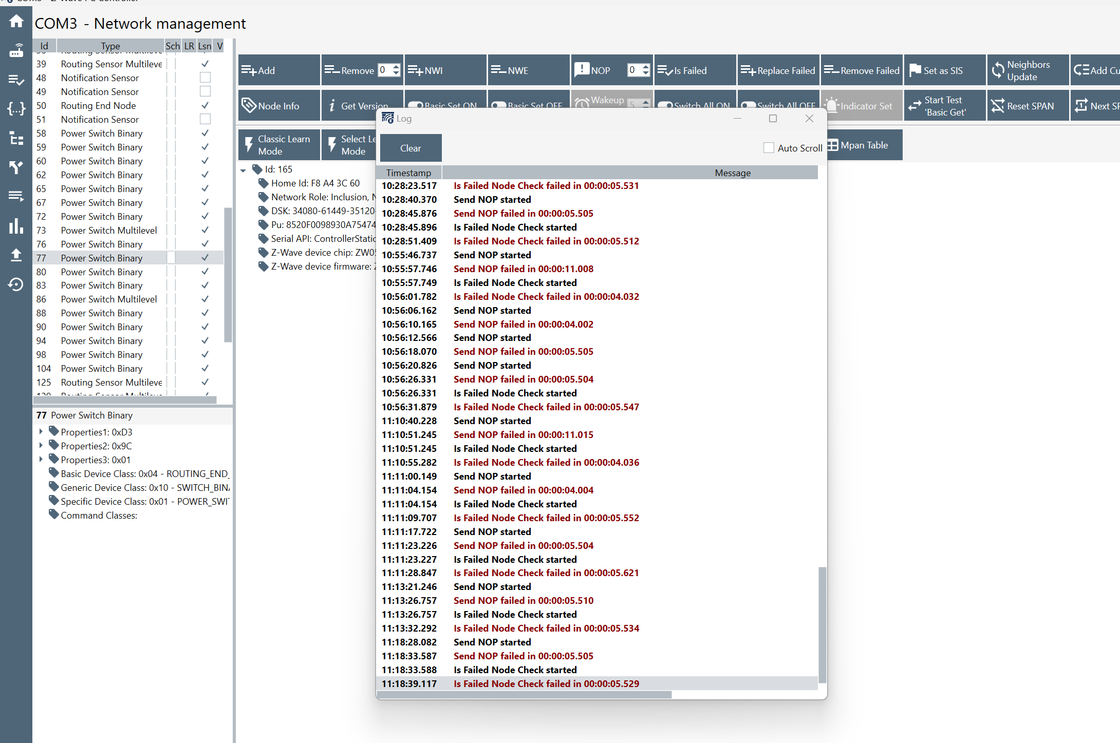

Check PC Controller logs to see why it wont remove it if still not working.
After clicking isfailed the device never goes into a red state (ready to be removed) even though it has no power to the device
Try node Info and/or Get Version, see if something responds to that, it should not.
Did you try using PC Controller after a clean shut down and reboot so the radio is in a fresh state?
What does logs in PC Controller say after the is failed does not work? (I think bottom right corner has a button to open logs).
I would exclude the USB Stick and remove it from the hub and then pair it again. That has worked for other people in the past although not sure where it was failing exactly, I never asked for logs.
I have tried this and the pc controller logs during "isfailed" action the logs shows "is not failed" but the unit is already joined to the other hub and tested as working

FINALLY, it took me almost a week to rid the ghost. Not sure if it was the stick I was using but 20 minutes ago with the UZB7 stick, no success. Removed the UZB stick and paired my Aeotec stick(Z-wave 500), which I hoped would work since part of the ghost issue is with the 700 series, which the UZB 7 is. So the Aeotec stick WORKED, finally.
Oh and also I had to reboot the hub right before "is failed" then "remove failed" in PC Controller.
