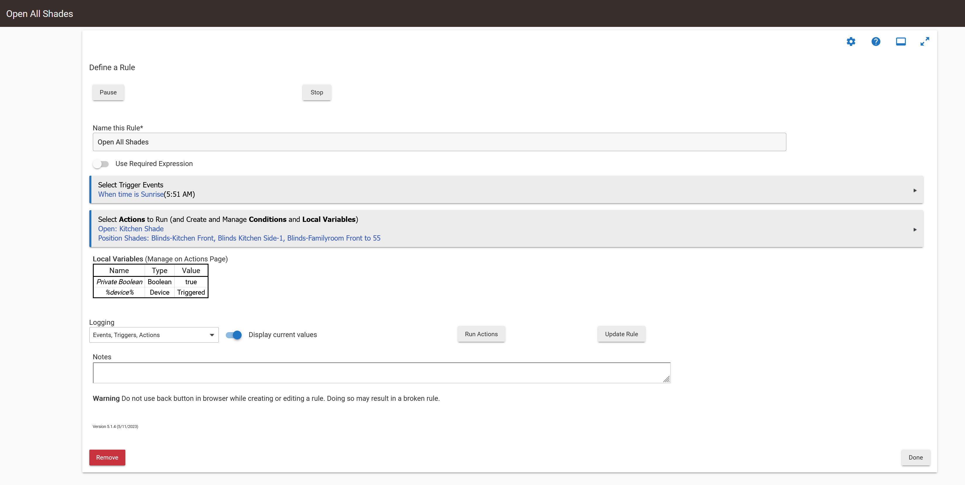

I simply use a rule to open mine... Works fine...
I originally had mine (2 blinds acting as a group) in Room Lights, but my blinds perform better if I meter the commands a wee bit, so I moved the control to Rule Machine.
These blinds are always either full open or close, so setting intermediate positions isn't a concern for us.
I created 2 virtual switches (1 for Open command, 1 for Close) and built the respective open or close sequence rule for each virtual switch -- that's where I metered the command to each blind and built in a refresh-redo-if-necessary command too.
Then I can use those 2 open/close rules anywhere else I want (Button Controller, time-based Rule Machine rules etc) simply by leveraging the "Run Actions: [original rule name]" command -- that works really slick.
