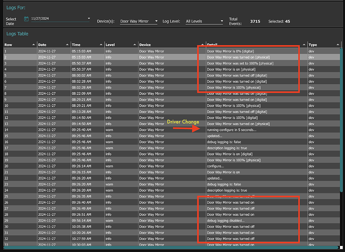

Apple Home shows the bulb as being "on", but the bulbs are not actually on. HE logs show the bulbs being turned on but again, nothing is on. The bulbs can be turned on/off from Apple Home or HE device tab or using the physical switch on the lamp, so not sure what is going on.
HE Logs:
The event at 5:50 AM is the turn on/off of the physical switch
Device Events:
The one thing that I can't figure out is why the bulb level is being set to "0%". That would explain why when the light comes on, it doesn't appear to be actually on but this is just a guess.
Any ideas on what may be going on? I noticed this in the past couple of days and there have been no changes to HE (Platform 2.3.9.200, C-8, Driver - Generic Zigbee Dimmer). Thanks for your help.

Switched the driver for the 3 bulbs to Sengled Element Classic. When I was changing the driver, I noticed that the "Device Name" was set to "Sengled Element Classic", so when I originally paired the bulb(s), it probably picked up that driver. Not sure how or why it got changed to "Generic Zigbee Dimmer", but I re-selected the driver you suggested.

Hmm - I don't use the built in apps (my automations are in Node-RED and use MakerAPI). After switching the driver, the lights did turn off automatically when they were supposed to, so and the level is still 100 on the device page :crossed_fingers:t3:
After changing the driver to the Sengled Element Classic, I am no longer seeing "0%" in the logs. Hopefully, this fixed it :crossed_fingers:t3:
Yesterday's Logs:
Today's Logs:
Note: The repeated on/off is caused by a lux based automation
