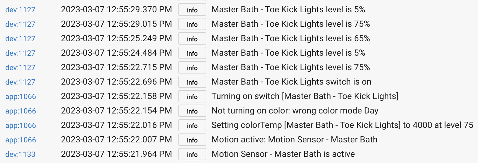

I have the following Motion lighting app configured:
When the rule executes, I see the following in my log:
Why does the light level jump around like that? This rule seems to "halt" other rules from executing for a short durations.
You shouldn't both set the color or color temperature AND turn the switch on. Setting either color or color temperature all by itself will turn on the switch. I don't know if this is the cause or not, but this appears to be a device issue. Does any other app set this light? What sort of device is it?
I recommend you move this app to Room Lights. You should be able to import the ML into Room Lighting to create an equivalent app.
This is a RGBGenie device. Ill test out Room lights and report back. No other apps control this device.

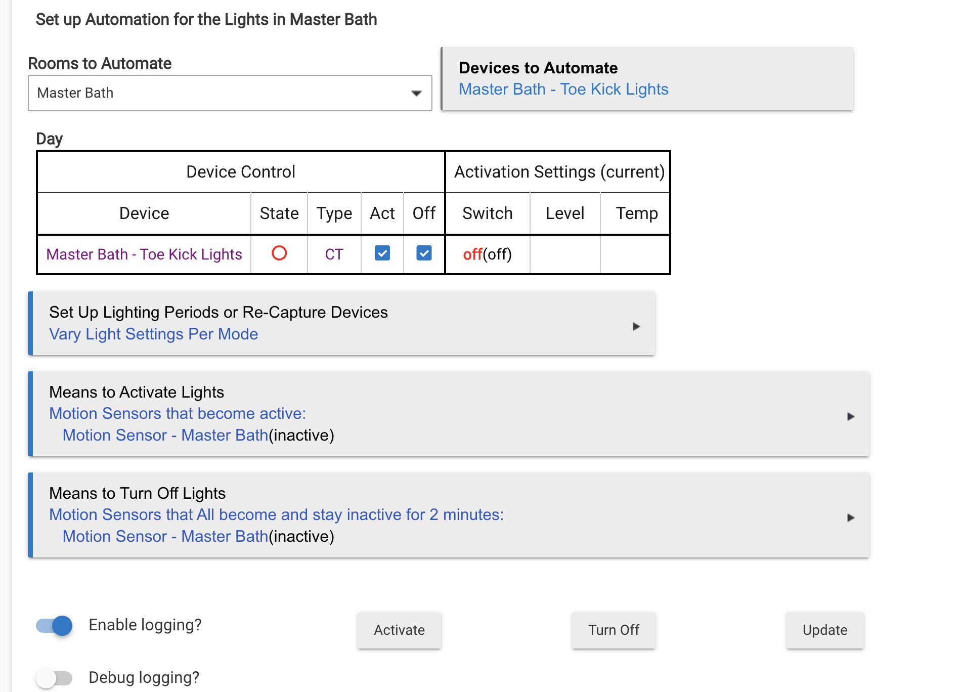

I moved the rule to Room Lighting as seen here:
When motion is triggered, the lights are not turned on at all now.

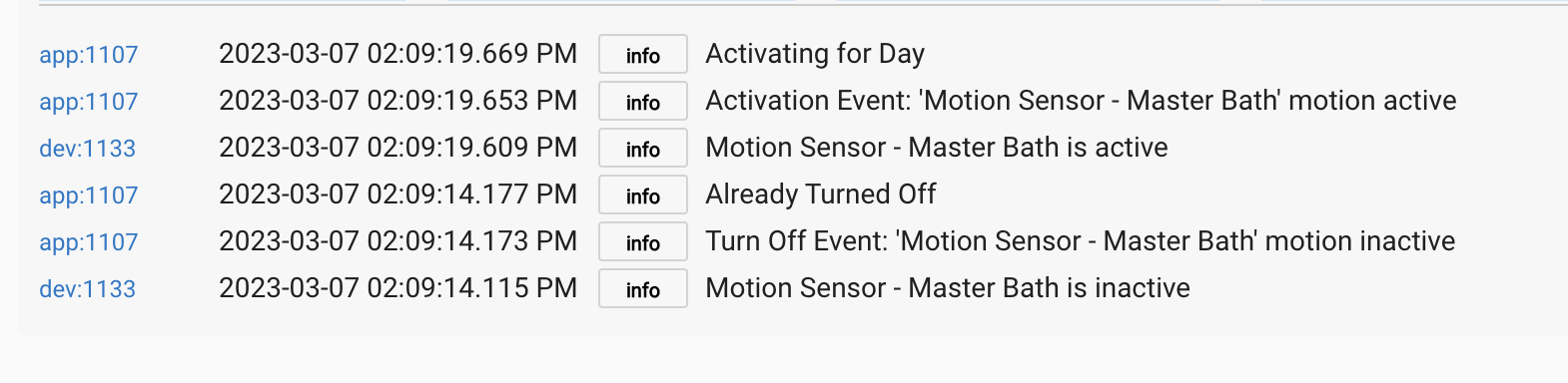

and here is the current screen from Room lighting after activation:
Disregard, I needed to set activation settings per mode. I think it might be working now.
