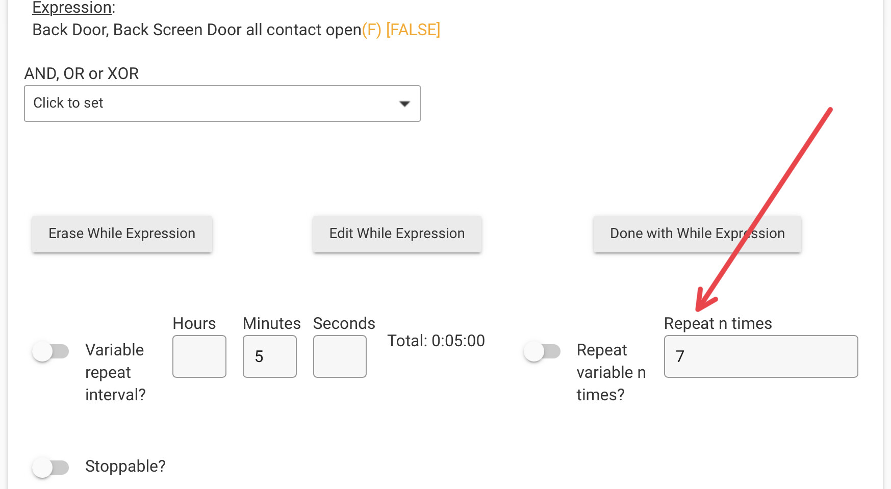

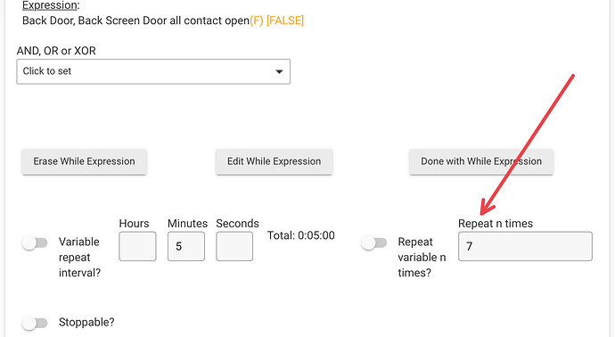

Is there an easy way to set a maximum limit on the number of repeats, even if the door remains open?
It should be noted that the new rule you shared, beyond the different order of actions, is further different from my suggestion above. I don't see any way your repeat gets stopped now. All I was thinking was adding the wait and notify inside your existing repeat. This issue that remains even with fixing the order of actions. (This being the first suggestion; the second would require substantially different actions and a different trigger.)
As for the question of setting a maximum number of repeats, yes, the "Repeat n times" option on the rule is the easiest way to do that.

Yes, there is an option in the while for a maximum number or repetitions.
