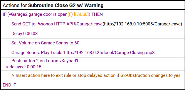

I have a warning that plays before the garage door closes. I'd like to stop playing the warning and not close the door if the GDO-Obstruction device value changes to on.

I haven't modified the existing rule. I'm asking how do I modify the rule to accomplish the desired result (stopping actions).
These are the existing rule's actions:

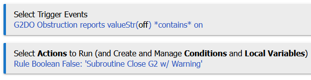

Is it possible to use a rule's Private Boolean in a Conditional Action? If so, I could create a second rule to change the value of my original rule's Private Boolean:
and change my existing rule:

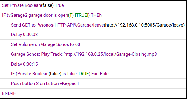

UPDATE:
I found the Private Boolean Conditional Action! I was looking under Variable because Private Boolean is described in the Hubitat Documentation as a built-in variable but it's listed as its own capability for Action Condition.
My rule actions are now:
And it works!

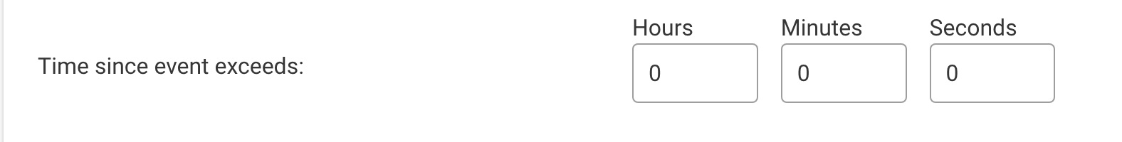

There is a Condition for Time Since Event. You enter a time for it, and it can be tested like any other condition in Conditional Actions.
