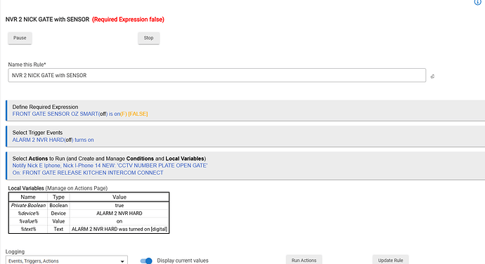

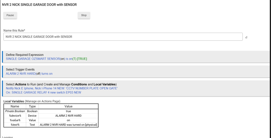

Good point re showing the rules. I have attached below images of rules and explanation. I have no doubt over complicated it but it works to date without the current issue of garage door closing.
Re the suggestion to use the gate as the trigger, unfortunately the gate remains open during the day.
Image 1 - Shows the rule to open the Garage door; The Trigger is ALARM 2 NVR however will not open if the Garage door is already open (because I only have 1 x trigger at the garage door for open/close) so I need to alleviate the door closing if already open.
The action then notifies my mobile and turns on the Garage door switch. this is perfect and works just fine when I am coming home. However when I am leaving this rule still opens the garage as it has closed by the time I get to the camera NVR trigger.
Image 2 - Shows the rule to open the Gate which is a parallel rule to the garage door but not an issue. just showing how I open gate and garage door from one trigger.

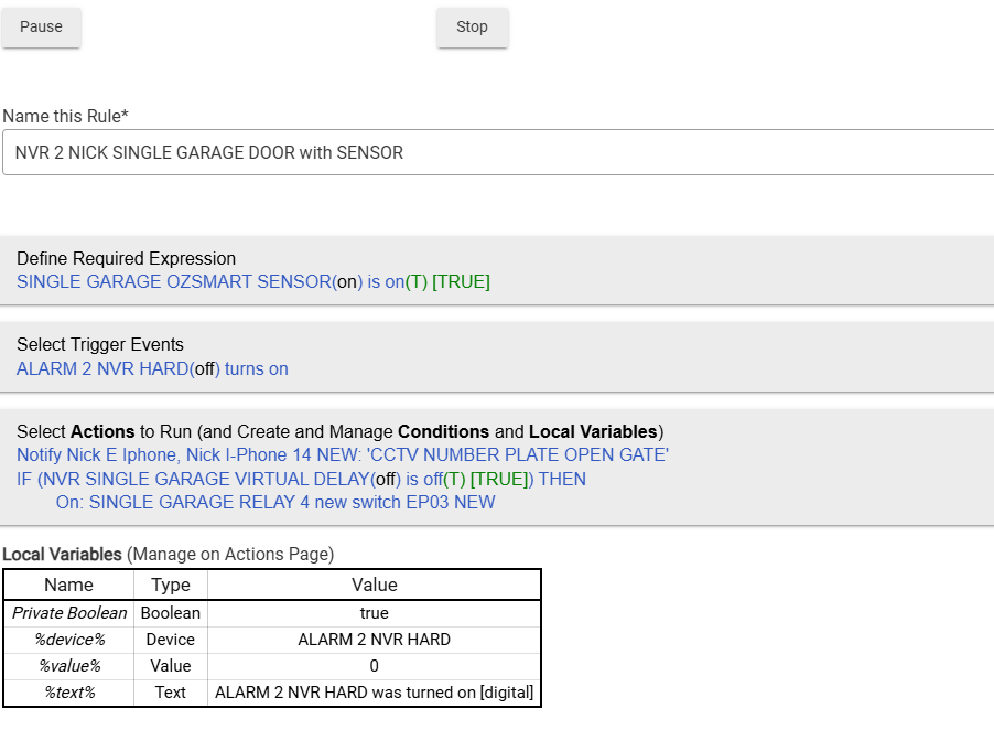

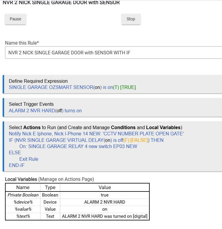

Lairdknox, I have tried setting up the Virtual switch in this case called "NVR SINGLE GARAGE VIRTUAL DELAY" and I had to place it in actions instead of say a required expression as I already need to use the required expression.
Can you look at the below and tell me what I am doing wrong. The Virtual switch is set up to start a timer for say 2 minutes once the garage door closes. this therefore should lock off the "ON" command to turn on the SINGLE GARAGE RELAY - but it is not working. the virtual works and starts the timer but the way I have set up the rule doesn't stop the activation.
any ideas? thansk again.
I think I sorted it.
