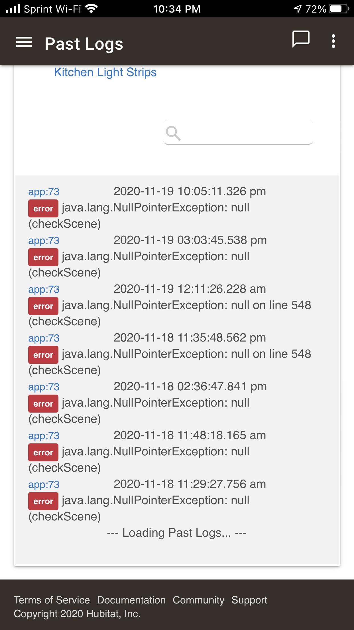

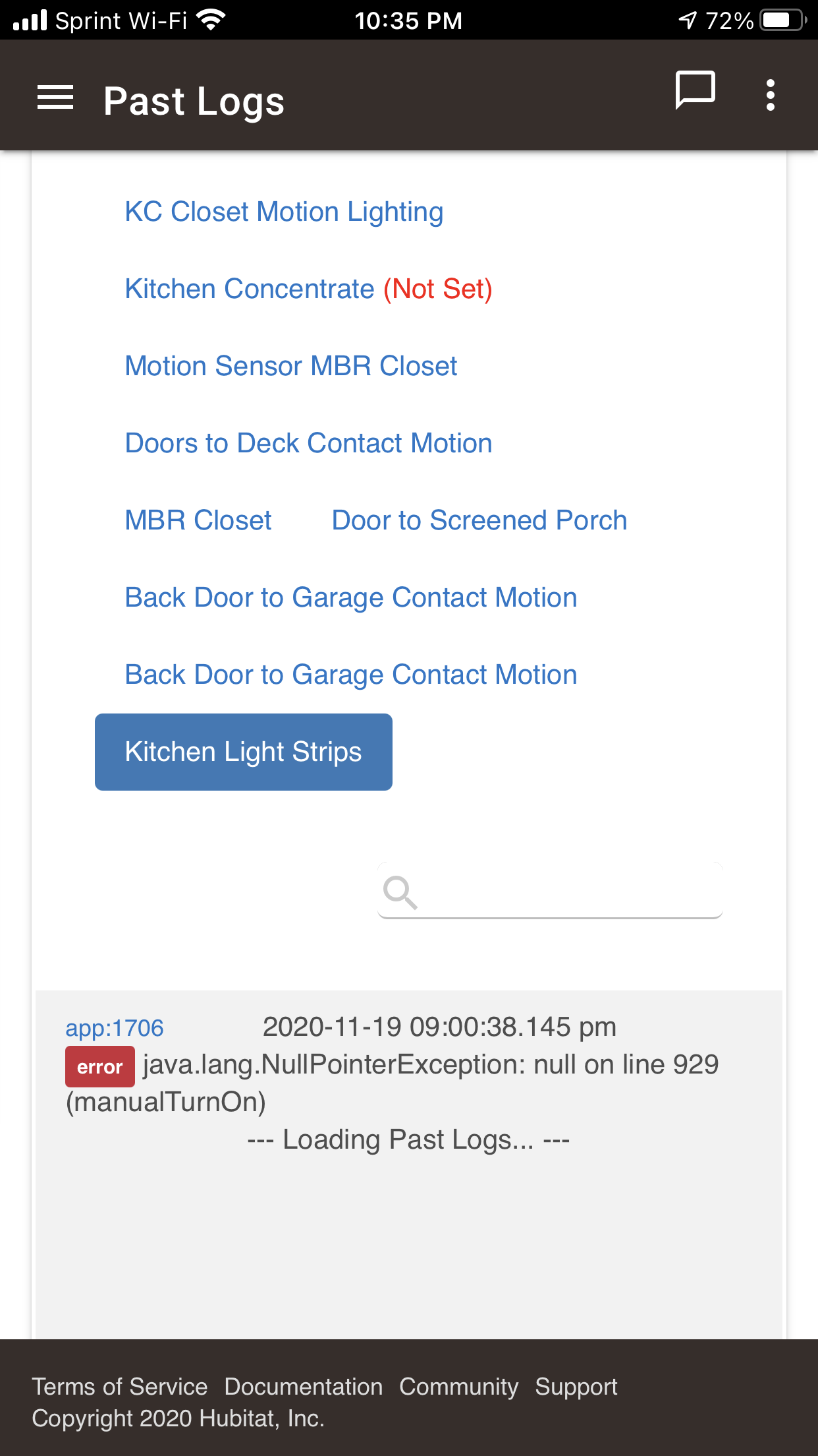

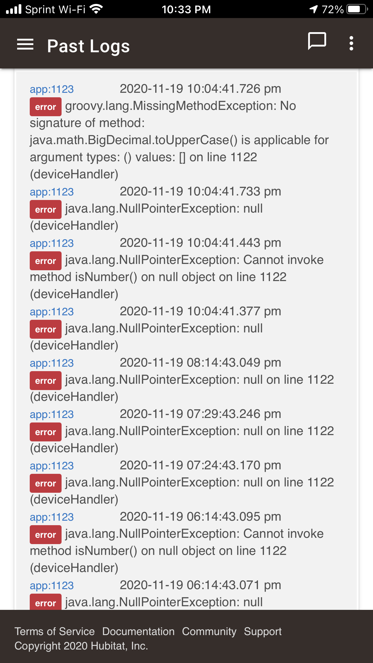

@gopher.ny and @bravenel, I’m still seeing the same errors in the Amazon Echo app, scenes with hub mesh devices, and some motion lighting rules.
Must not be critical since everything seems to be working, but thought I should mention it.

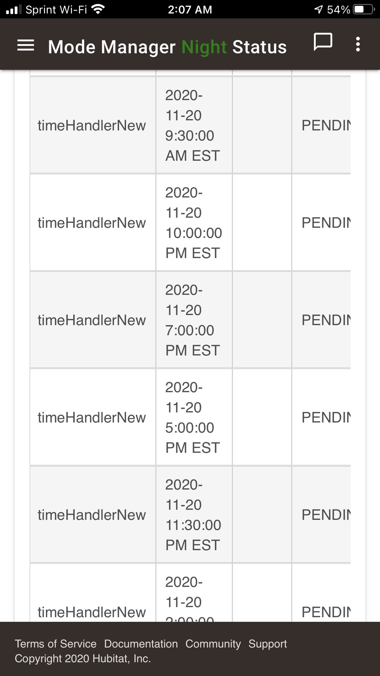

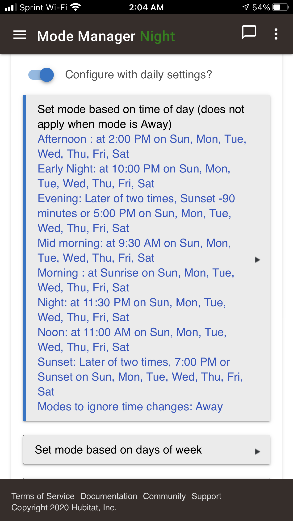

I also have noticed that my sunset mode that is supposed to start at the later of two times, sunset or 7pm, has been executing at 5:06 pm (sunset here). I’ll probably just delete and reinstall mode manager if going on and clicking done didn’t fix it, but just in case it’s relevant I thought I’d mention it. It appears to have the right time scheduled for tomorrow:
