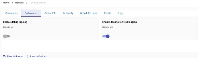

Hi, I've explicitly turned debug logging off for an Eve motion sensor, but I'm still getting messages like this cluttering my logs. Included snapshots below.
[debug] descMap: [endpoint:02, cluster:0400, attrId:0000, value:1125, clusterInt:1024, attrInt:0]

Did you click save on the preference page after turning “debug” off?

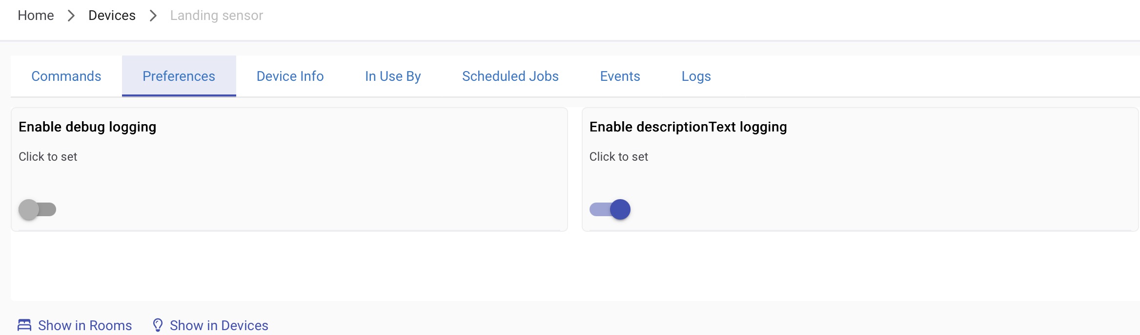

Yes. The screenshot I supplied shows evidence of me changing (and saving) that preference, see the two 'warn' lines near the end. That's where I turned debug logging off, and the debug messages continue, even now a few hours later.
This is a relatively 'chatty' sensor so it's creating lots of log entries I don't want or need.
This is an oversight in the driver, or perhaps left over from early development/testing where the disabling got annoying (just a guess :smiley: ). It will be addressed in a future build. Thanks!
Turn off the 'description Text logging' and see if that solves the problem
It will not solve the problem. The fix, which I mentioned I had identified above, is currently in beta.
