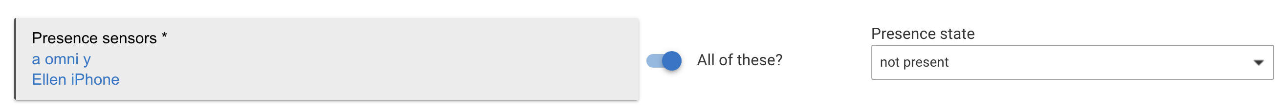

How about "NOT Wife, Daughter any present"? That's the same as "Wife, Daughter all Not present".
Like this (omni y is a presence sensor):
Those two sensors are stand-ins for Wife and Daughter. This is the Condition for the Action to turn on the music.
Thank you! Will even work if I arrive at the same time as my wife (playlist will not start)
