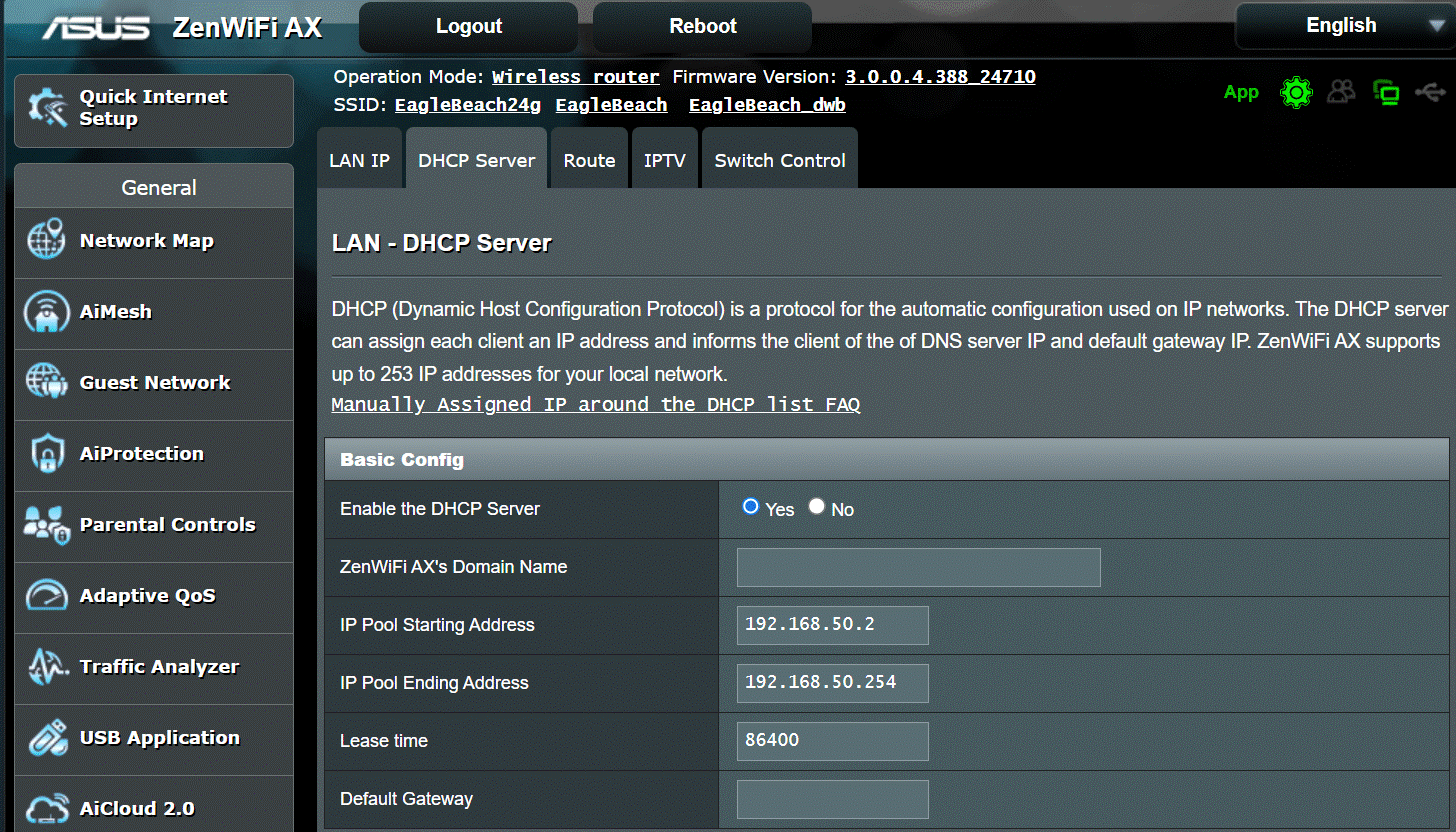

Also, the address reported by my hub (last two) is 1:220 But the IP starting address reported by my router is 50.2 and the ending sequence is 50.224 How can my HUB report an address that is not in this range and is this the issue? How to fix?

The only way I can see your router giving the Hubitat an address that is higher than your range would be if you set up a static IP on the hub and that address was outside the range it hands out. If that were the case, it should not be changing though.

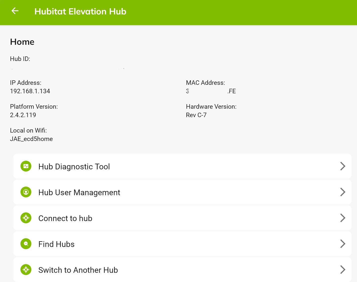

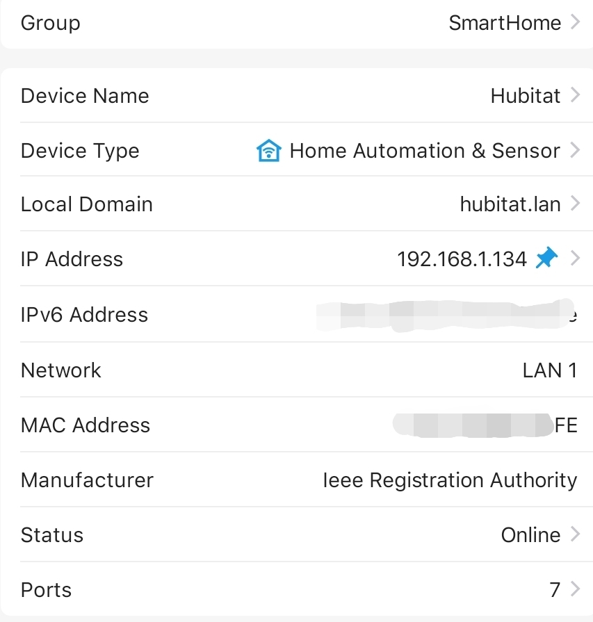

No, I didn't assign a static IP on the hub; I just let the hub assign whatever it wanted automatically. I'm attaching a screen shot of the HUB detail tab reporting of just the MAC address and IP addr
ess. Also, I connected the HUB via ethernet cable to the router and a snap of the router setup screen. I can't send a snap of the setup with the Hub ID as you suggest as I don't know where to find it on the router side; I can just see it from the Hubitat side.

I think I found my mistake thanks to you all. My ASUS router is connected to the AT&T router/wifi device and I plugged it in to the AT&T router not the ASUS which is what I use for wifi and all else (I have the wifi signal disable on the AT&T device). I'm sure that is why I could see it on the ASUS side. I have connected the hub to the ASUS router now and rebooting.
Again, thanks for the help. The question on ensuing I plugged into wan or lan prompted me to go down and take a closer look. My bad.
