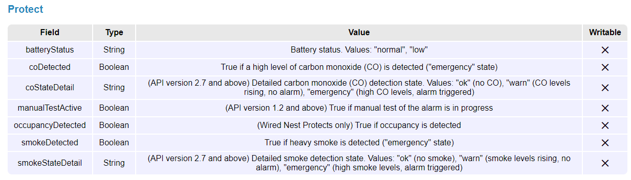

The SDC supports the following RO attributes:
The native Hubitat Capabilities/Attributes for a Smoke Detector are:
SmokeDetector
Device Selector: capability.smokeDetector
Driver Definition: capability "SmokeDetector"
Attributes: * smoke - ENUM ["clear", "tested", "detected"]
The Carbon MonoxideDector capability is identical in terms of Enumerations (Clear/Test/Detect).
I was personally interested in bring over the the Occupancy/Motion booleans over from the Nests, and I just did that via a mapping into Apple HomeKit, then pushing that bit to HE via virtual switches via HomeKit automations - That works just fine, and was fairly easy to do.
Adding/editing the above Doorbell App/Driver is possible (it creates child devices, from best I can tell for each doorbell, and it would be easy enough to create Child Smoke dectors for each Protect).
But what exactly are your trying to get from the Protects, given the limited attributes of a HE SmokeDector - Some of the Starling fields don't seem that interesting (aka a manual test underway) or are you after the CO / Smoke states and their details? - I guess what I'm asking is what is your endgame here, to automate or get what details from the Protects, to get into HE - as some of the mapping of the SDC details, don't easily match to a Hubitat capabilities for Smoke and CarbonMonoxideDectectors

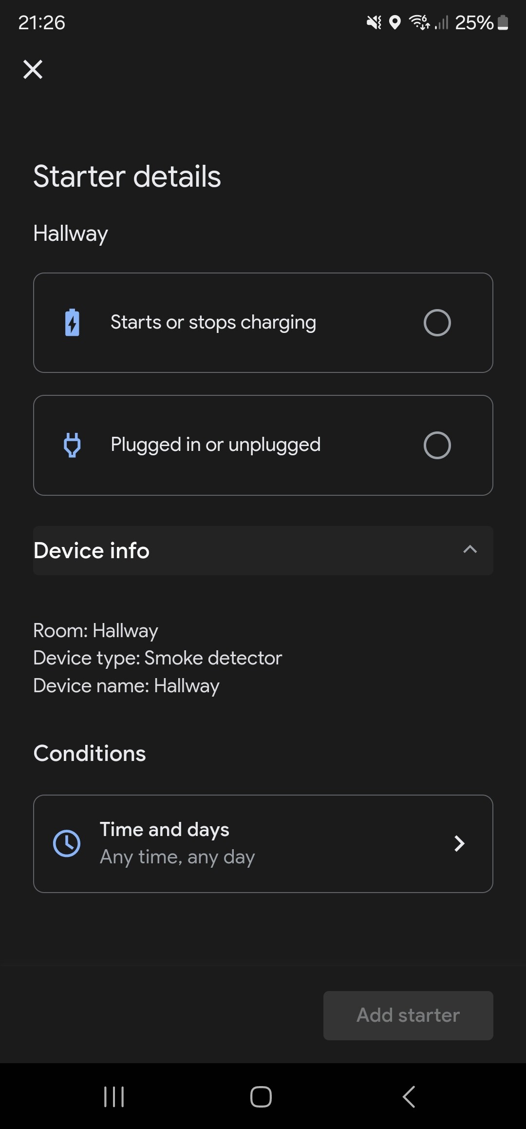

I see they have added nest smoke alarm to Google home , it won't let me create a routine from a alarm only gives me the option if unplugged or battery, hope they will allow me to create a routine from a alarm soon., which then can use virtual switches to trigger things

I did find something out, that if you go to google home and view in a browser, using the AI routine script editor it does show the sensor has low, medium and high and no smoke and smoke detected options
So might play with this to see if i can get it to trigger my virtual switch (fingers crossed)
Only thing is . there is not away to test it?, as when it to "Check-Up" nothing happens
