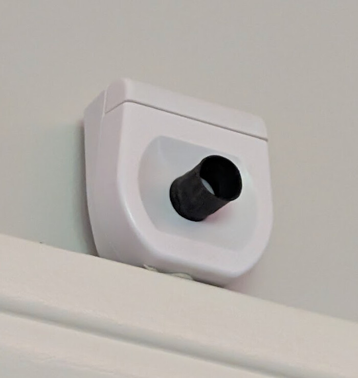

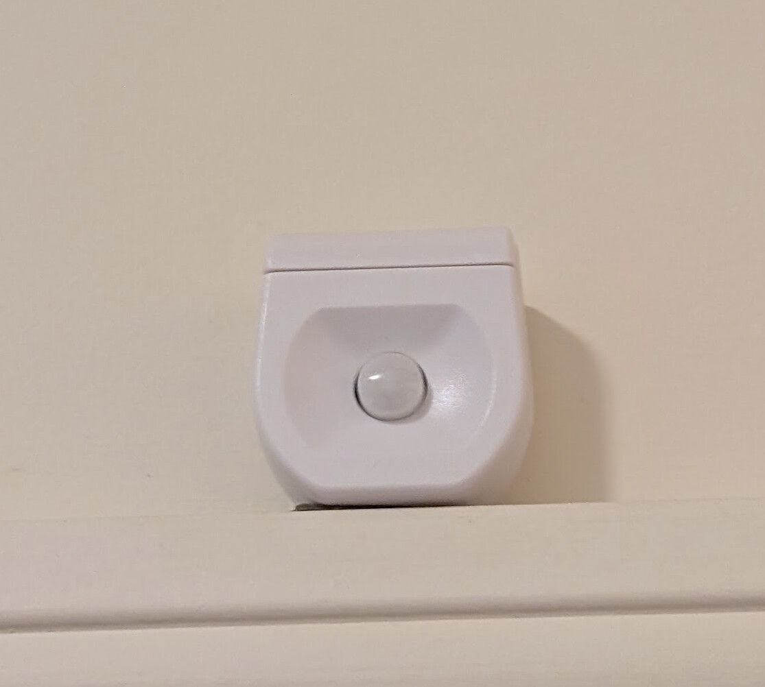

One old trick is to put heat shrink tubing around the PIR sensor, which limits the field of view. I've got a few like that so limit their view into busy areas.
Before and after pictures:

I have done something similar with an EMT conduit bushing. They are white plastic that matches the sensors fairly well. Example I can't remember if I used 1/2" or 3/4", but they are cheap in a multipack at the hardware store. (much cheaper than Amazon)
A plastic pipe coupler for PVC also might work if you have one laying around.
I used a hot glue gun to attach the conduit bushing.
