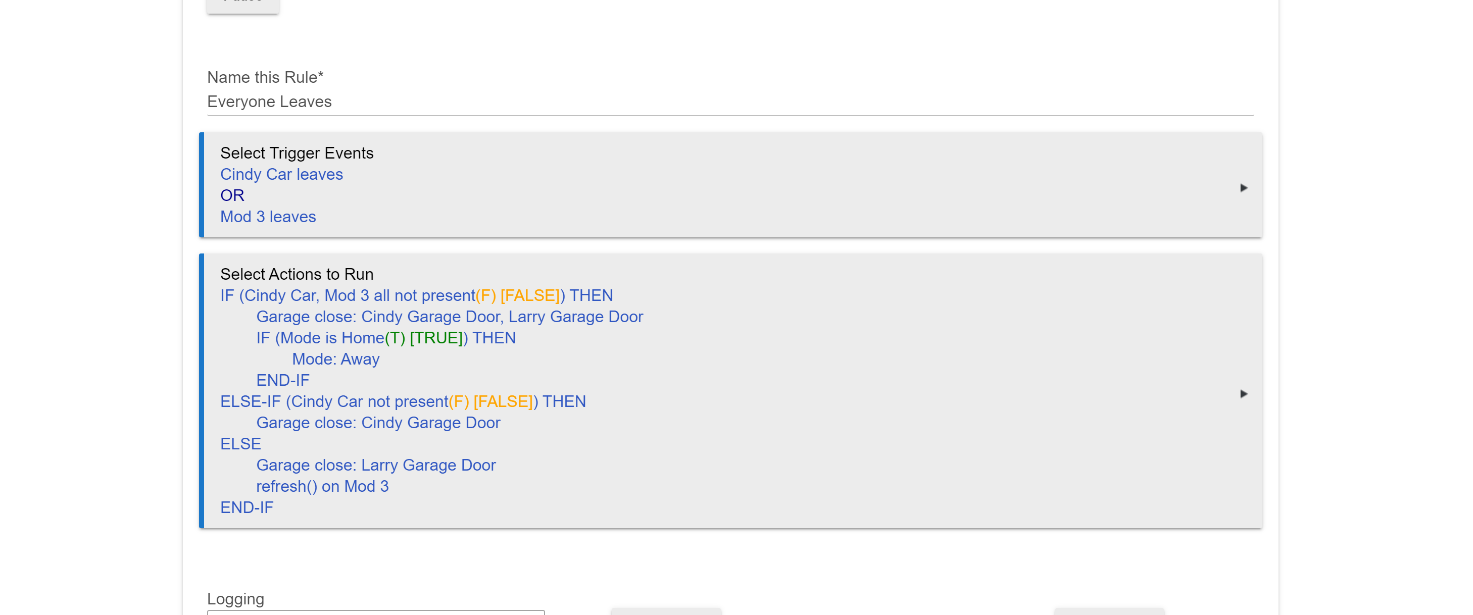

I also put velcroe on the box and attach them to the back deck in each car. Then i change device desc to be the car not a person and make rules based on that accordingly.. Recently though i dont need one for my tesla as the integration itself has presence and it opens the garage door so i dont need an automation like i do for my wife car..
