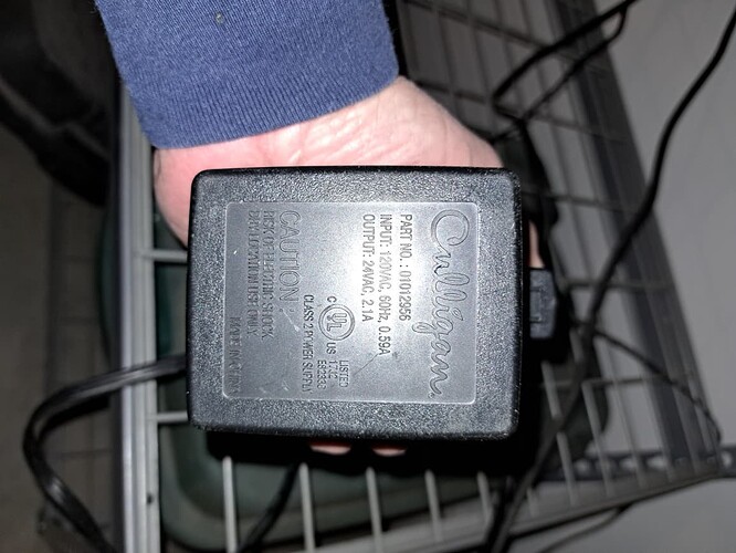

The wall-warts for water softeners are typically 12V, so 25A at 12V is only 2.5A at 120V - definitely not a high-current issue.

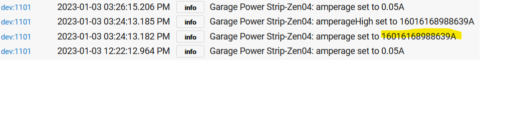

BTW, I'm having other occasional spurious readings from an Zen04. How about the beauty below? Still low amps, so I'm assuming no trip.

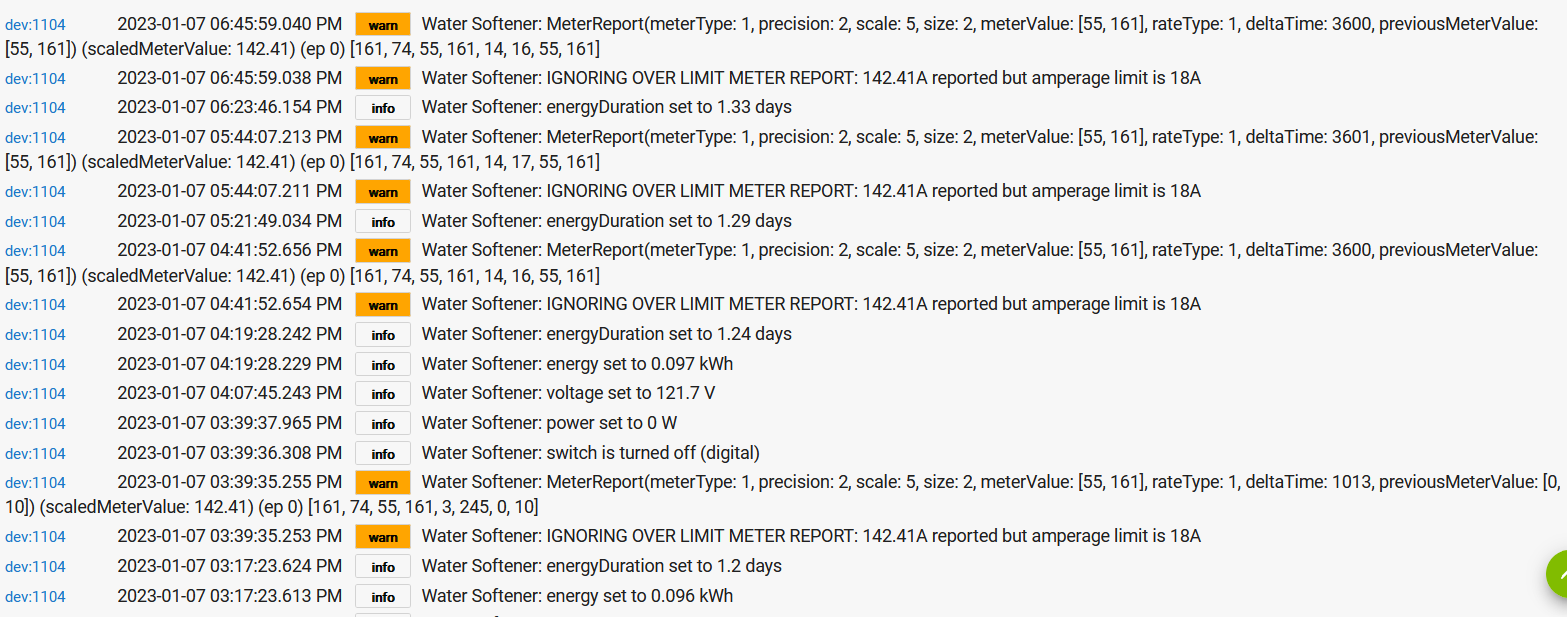

I'm on the lookout for any future spurious data; have notifications set up. @jtp10181 is on the case. He's thinking corrupt data transmission. Perhaps the water softener plug shut itself down on overcurrent all by itself due to the wall wart and another plug behaving similarly. Suggests setting up a trace log, but that it consumes bandwidth.
I've got 13 of these in service now, perhaps foolishly, lol.
The trace logging wont use zwave bandwidth, it will just create a lot of log entries especially with 13 devices going. Could install a second copy of the driver and edit the name of it, then enable the trace logging on that one, its the very bottom of the code you just uncomment the log.trace command. Then use that driver on only select devices to try and capture more logs.

I got to it before it ran out of log space (I haven't messed with the log settings yet.) Hopefully, this will tell @jtp10181 something. To me, this trip is internal to the switch.
