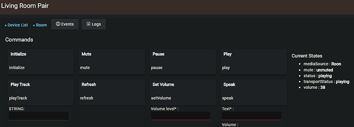

I just send text to the speaker and it speaks.
I just sent a test to the one in the office from the device driver input and it works fine.
Seems to be a Group thing maybe.

All I seem to be able to get is the bell, but no voice, and only when I first try to use the device. Pretty sure I used to be able to.... When I try sending another speak request nothing happens.
EDIT - Now it's working.... :slight_smile:

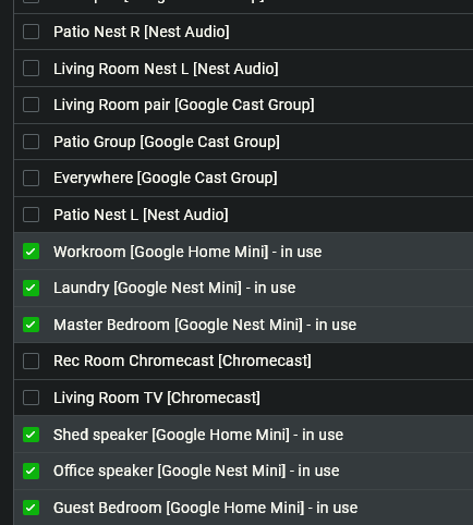

I did just discover that if you run Discover it created some, not all, duplicate devices. :frowning:
As my pistons point to the previous device they now stop working until I delete the old device and use the new duplicate.
Testing the code now.
Yup. The duplicates created by Chromecast Integration Discover threw the old devices out of WebCore but left them in the Devices list going nowhere.
I deleted the duplicates and added the new ones to WC, all good now.
