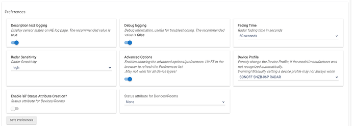

I will add this device to the Tuya 4 In 1 driver later (thank you for the logs!), and we can continue the troubleshooting with this driver which I know better : )
@klinquist please install the 4 in 1 driver latest dev. branch version :
https://raw.githubusercontent.com/kkossev/Hubitat/development/Drivers/Tuya%20Multi%20Sensor%204%20In%201/Tuya%20Multi%20Sensor%204%20In%201.groovy
Click on the "Initialize" button from HE device web page and let me know the result..
Lots of errors before I hit initialize, seems good after... I'll test it today...

After a while this is all I see under Current States...
CleanShot 2023-10-22 at 09.36.17@2x
Enable the Debug logs and pair the device again to the hub.
I will need the debug logs after the pairing started.

@user4207 please update to the dev. branch version ver. 1.6.8 2023-11-13.
I have added the configuration of the radarSensitivity and fadingTime preferences.
Keep in mind that fading times of less than 1 minute are outside of the specs.
Make some tests with different sensitivities - do you see any difference?
