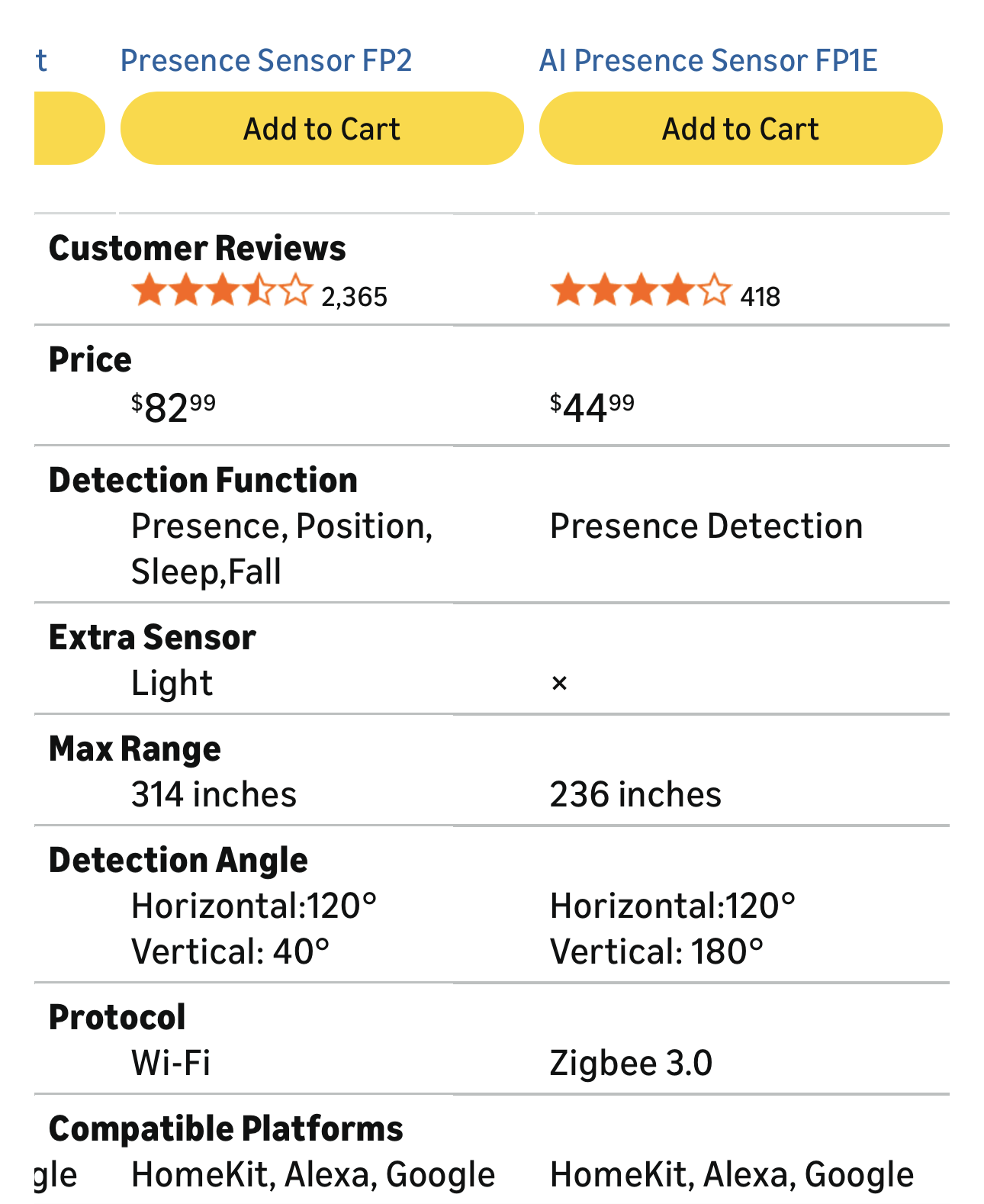

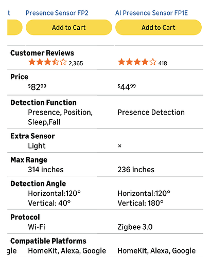

Thanks … Amazon is showing a FP1E also that is wired and Zigbee. They show the FP2 as WiFi which is confusing.
That’s right. I had gotten my FP1 from AliExpress, but they never sold on Amazon - they did sell the FP1E which are the same.
The FP2 are indeed WiFi and connect via the HomeKit protocol to the C8 Pros. The Aqara app is used to define zones, and that happens on the cloud. However, the motion events are local.
Okay, got it. I also got my FP1's from AliExpress. I'm tracking you now. I think I'll pass on the FP2, since I don't want any more WiFi devices.
