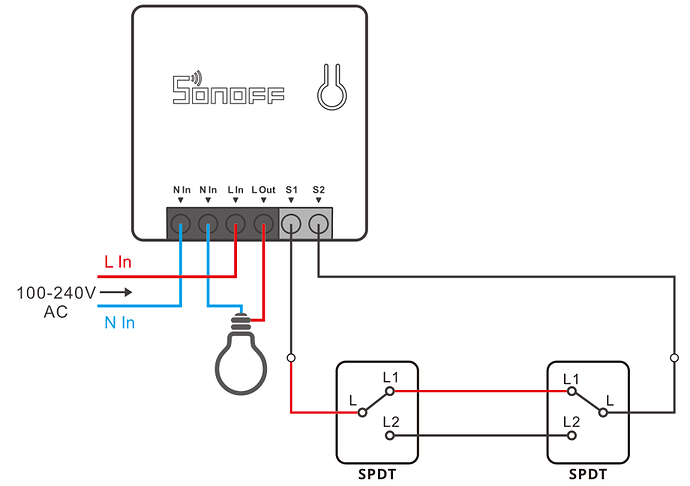

This device is called a two way switch, however here in the USA and likely elsewhere we know them as 3 way and 4 way.
The switches are not connected to mains power or the load. They are stated to carry a lower power signal that is "safer" than mains power. I did not measure any voltages so I can't attest to their safety.
It is easy to create a 3-Way (as shown below) or 4 to N way with this device. My switch runs are only about 20 feet each so I don't know if very long switch runs will be an issue or not.
Their diagram shows two "SPST" switches which are EXACTLY the same as a standard 3-way switch. In this case the "L" terminal would go to the black on the typical 3-way switch. Of course you can use it as a simple 1-way as well.
