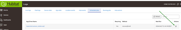

To get rid of the error message :
Go to Logs -> Scheduled jobs and find your device checkEventInterval scheduled job
