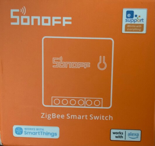

I when I power on the switch I can see the green light blinking but the Zigbee intergartion never seems to find it. Am I doing something wrong
Turn on zigbee pairing on your Hubitat. Then press the manual switch for 5-10 seconds until the LED flashes and then release.
