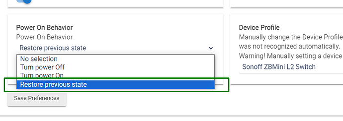

You can use this driver :
https://raw.githubusercontent.com/kkossev/Hubitat/development/Drivers/Tuya%20Zigbee%20Switch/Tuya_Zigbee_Switch_lib_included.groovy
Configure the desired power-on behavior and click on the Save Preferences button :

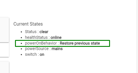

If the device confirms that configuration, you will see the setting in the 'Çurrent States' section :
