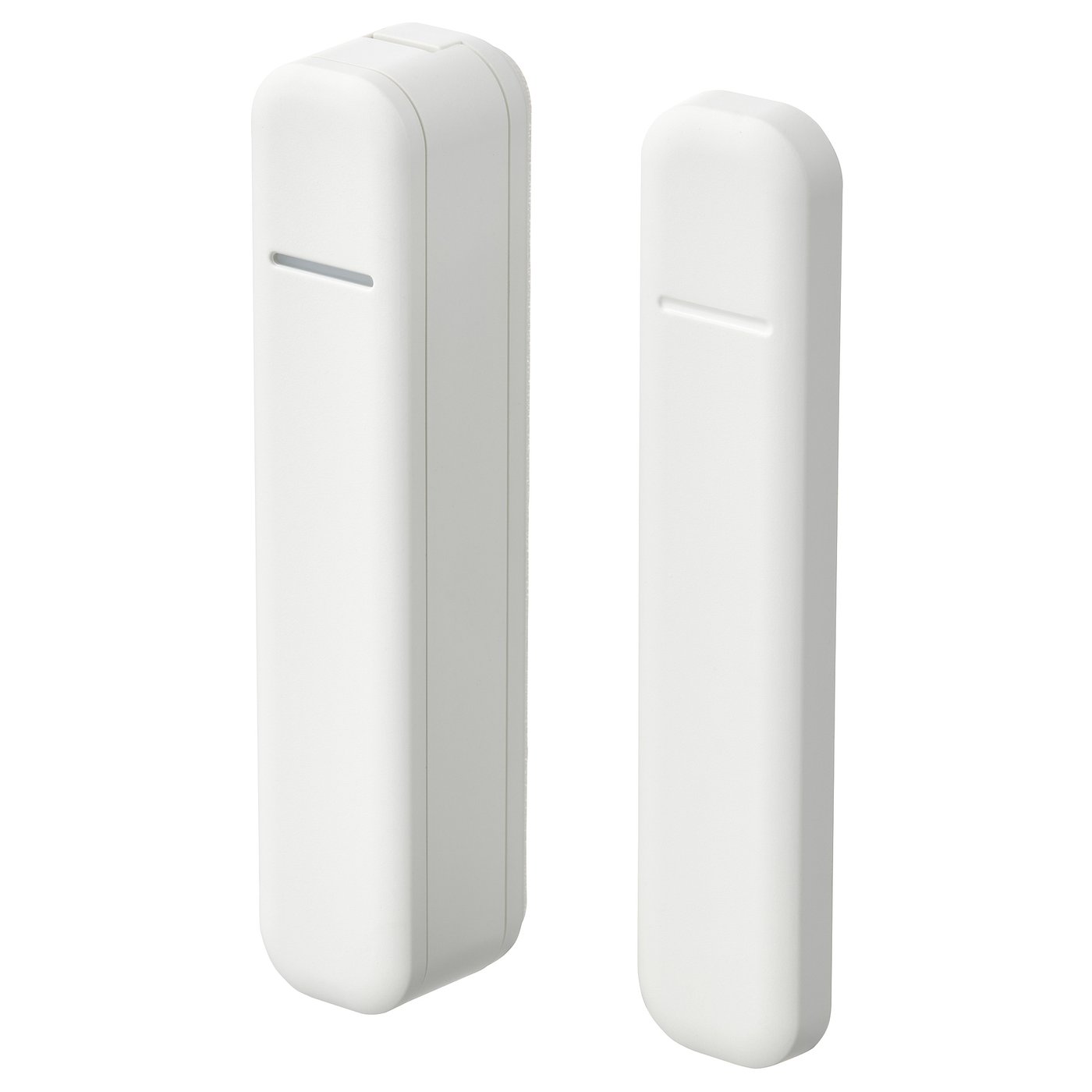

IKEA's new line seems to be gaining popularity. Haven't tried any yet myself, but the 365 day return policy should ease any qualms.
New PARASOLL
Door/window sensor, smart/white
$12.99CDN
