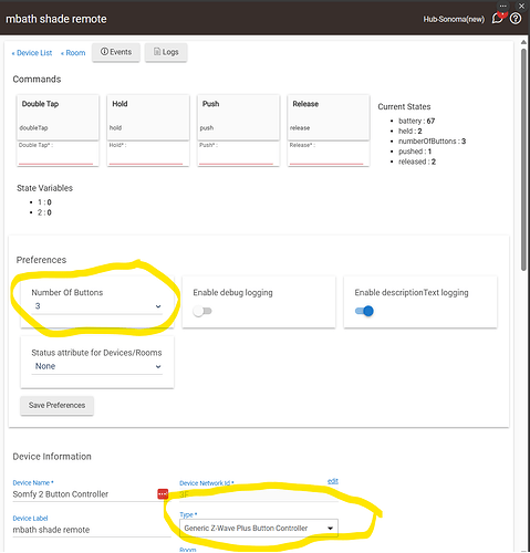

After you've included the remote into Hubitat, you can change the driver to "Generic Z-wave Plus Button Controller" and configure it to have 3 buttons. Once you do this, the 3rd button will be recognized by Button Controller, and presumably any other app that originally only showed 2.
Screenshot below.
