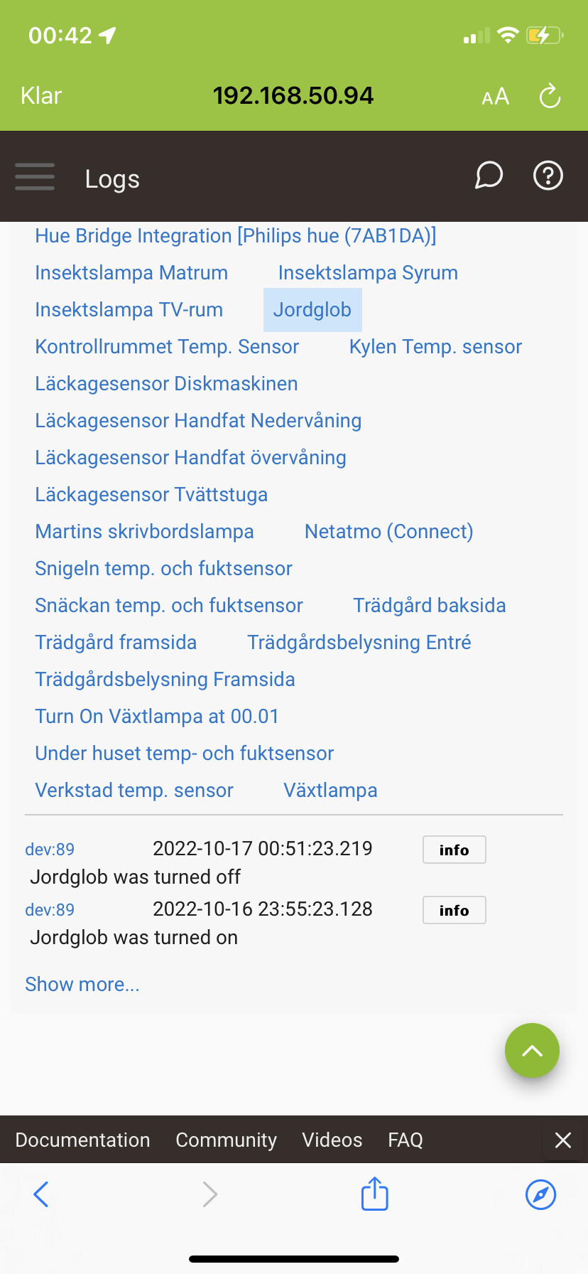

Did that a while ago but cant get anything useful out of those logs. When I click on the Info-button in the log it only directs me back to the device itself.

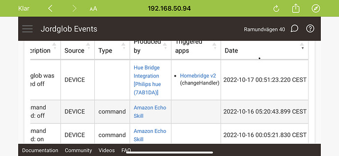

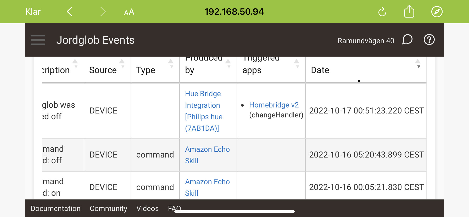

Check Events page (button at the top) on device details page. If an automation is triggering the bulb, it should show up there.
@gopher.ny @rlithgow1 It’s running through the Hue Bridge. I cant get anything from the logs or event I’m aftaid. This is the info I get:
So as you can see, the last entry is from around 17.00 yesterday even though the same thing happened around midnight yesterday and tonight.
