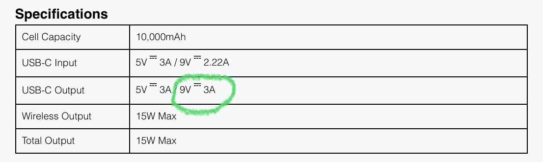

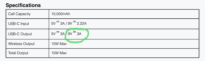

The Home pod mini is very picky about power. The 20W part is easy enough to do but it has to at 9V and at least 2.22A. If your USB-C battery does not do 9v (not all do), it will be a good start.
This is from the Anker MagGo Power Bank manual and has the correct volts and amps but somehow the watts aren’t enough… even though 9v @ 3a is greater than 15 watts. Either way if your battery can output 9v at, at least 2.22a and at least 18w, it will be good to power your HP mini.
