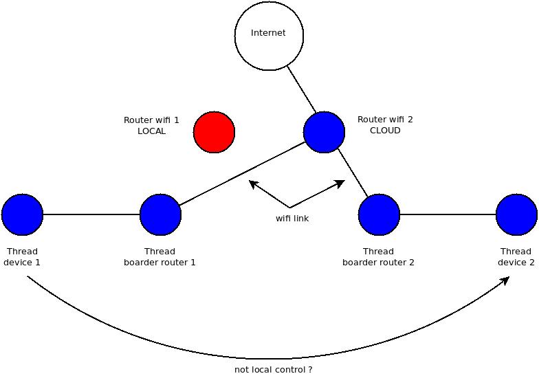

Maybe I did not explain myself clearely. This is the situation I'm talking about:

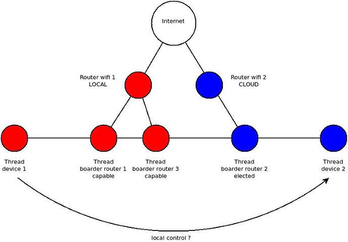

And what about this situation. Is this local control?

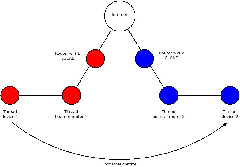

Am I correct thinking these 2 previous situations are not local but this one would:
Your blue and red networks would have to be set up separately, if they connect anywhere in the Thread network they are on the same Thread network. Some documentation says that external routing can be disabled on specific routers. There's a fair amount on the details on the Thread Group website. Maybe this one helps? https://www.threadgroup.org/Portals/0/documents/support/BorderRouterWhitePaper_657_2.pdf
