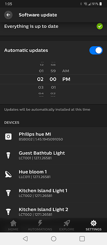

I have hue bulbs on hue bridge and mine come on after an outage . I.double checked the settings and they still come on. So.I gave up.and wrote this rule.
That is really strange. I have two Hue bridges and 2 different generations (with and without Bluetooth) of Hue bulbs, some color and some white ambiance. None of them come on after an outage; not even briefly.
Although, I’m not familiar with the bulbs and firmware you posted.
Much different than mine:
