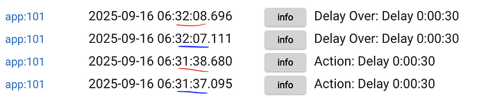

As @hydro311, @bertabcd1234 and others noted, the hub logs would have revealed this. Here is an example screenshot of logs showing two overlapping executions of one rule with only a 30-second delay action:

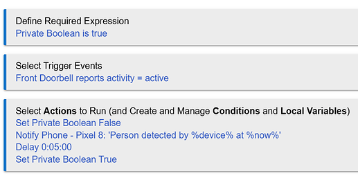

Yes, here is my final rule which is working as desired:
