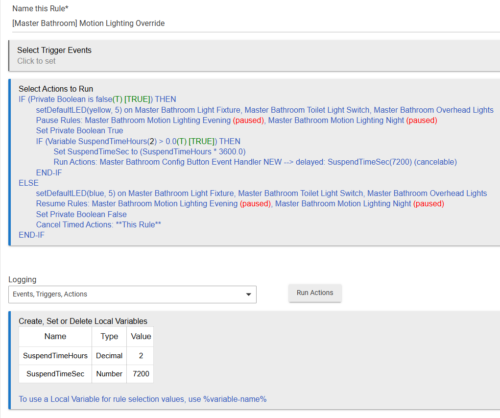

I'm not sure what happened, but my rule doesn't appear to work anymore. This rule was created years ago, never touched, and I never had trouble with it. But it's not an often used rule, so I'm not sure when it broke. It could be many months ago.

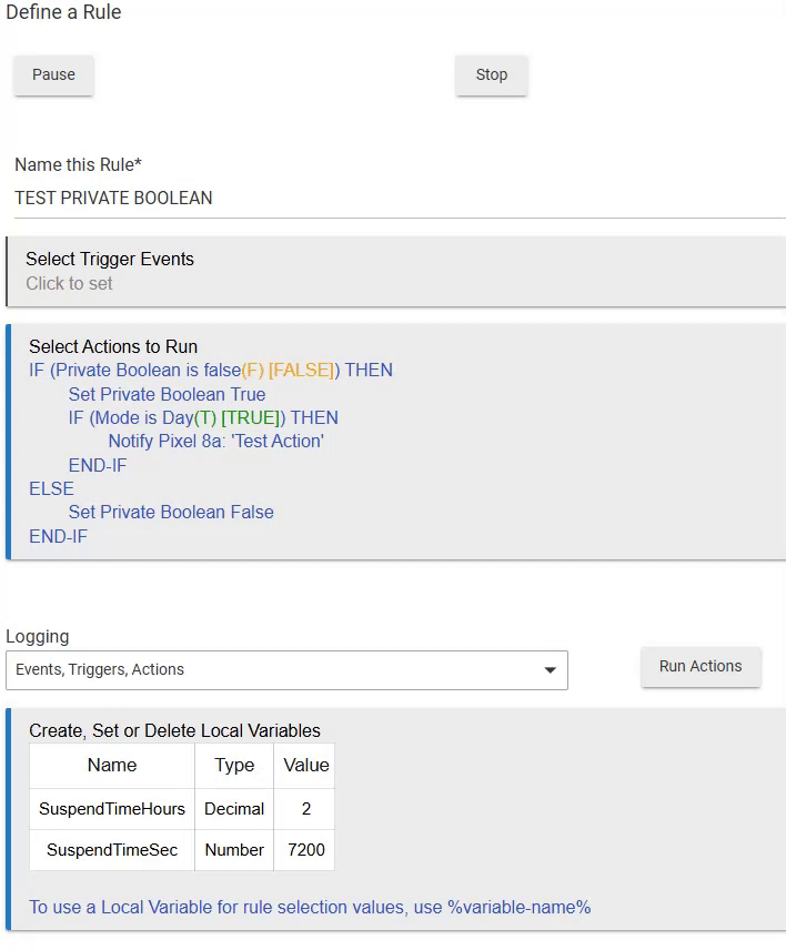

It looks to me like the Private Boolean isn't being set. When I click Run Actions, I'm expecting the Private Boolean is False(T) [True] line to toggle, but it doesn't. The If else structure ensures that it always toggles. Is there another area in the UI for me to check and manually toggle the rule's Private Boolean? It's been years and I don't remember if there was a way to do it.

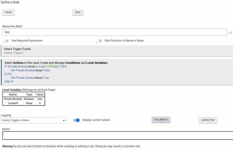

I don't seem to have the ability to create new rules in Rule Machine Legacy, so I created a test rule in Rule Machine with the if-else statement to toggle it's own Private Boolean and it works as expected. I can also see Private Boolean in the Local Variables box, whereas I can't see Private Boolean anywhere (except in the actions itself) in Rule Machine Legacy.
Maybe I can use the clone feature to create a new rule in Rule Machine Legacy to test this there. I want to test if something structurally changed that broke my once-working rule.

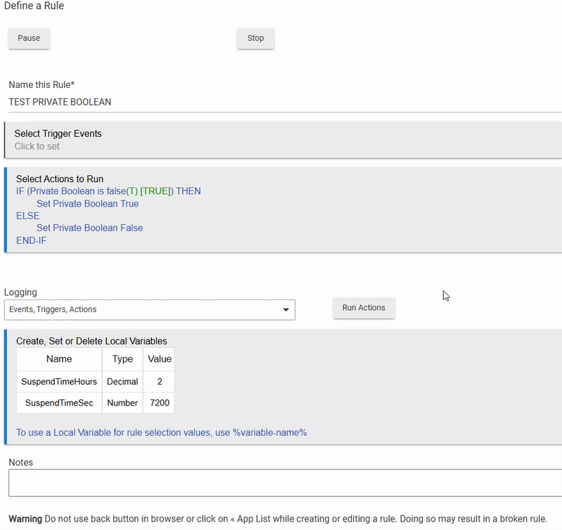

Just did the clone trick to create a new rule in Rule Machine Legacy and this works as expected:
Recording2025-04-26111216-ezgif.com-video-to-gif-converter
Hmm.... More investigation needed.
When I clone the original rule, and re-set the the boolean setting to point to itself rather than the original rule, it still doesn't work, so it's not that specific instance of that rule that is broken.

I have discovered the root cause! In re-creating the rule in the new RM, I found the new rule also doesn't work which led me to find the culprit. It's getting hung up on my Custom Action line used to call a custom command, setDefaultLED(), defined in the devices' drivers. However, one of the three devices is inadvertently running the official Inovelli driver (which doesn't have this custom function defined) instead of the one I customized. I can turn on logging and see the error in the log file. Should've look there first! Doh!
