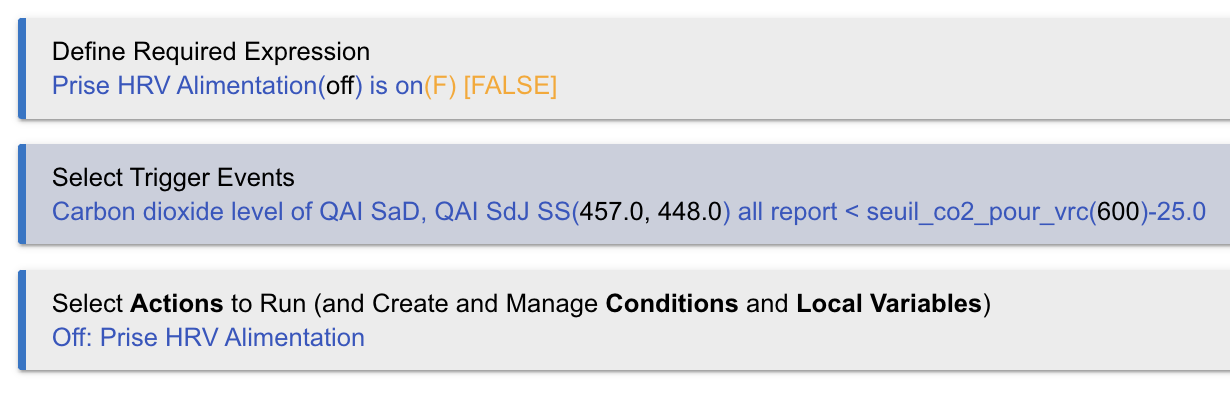

I disabled the original rule and created a new rule from scratch. In the spirit of retracing my steps, I did not use a hub variable to start. However I picked a CO2 threshold that guarantees the rule is triggered at the next event.
The rule was initialized while the switch was on, so the required expression was initially true. The rule was soon triggered. I started getting the repetitive "Required expression false" messages:
This is the event subscription section of the app status page after the required expression became false (the list looks the same as when the required expression was true) :
This is the rule definition:
