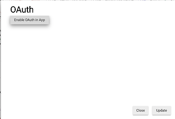

Open the app source code, and at the upper right click on OAuth. You can enable OAuth in the window that opens, then save the source.
Worked thank you!
