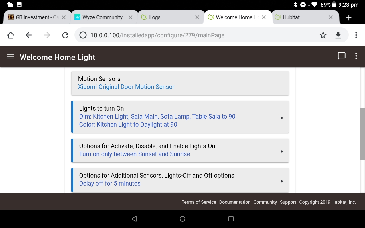

I have this setup on this rule... First I thought there was an error on the sensor..
But the sensor is triggering

What I meant is the motion triggered the rule and the lights didn't turn on.

Fyi I have replicated the rule in simple lightning and there it is working as intended. With Turn on and set level.
To clarify as well this are Hue lights connected through Philips Hue bridge.

I did another silly test and the lights turned on.
I have two Color lamps on that setup but was just setting a different colour for one of them. As soon I added all colour lamps to the set colour option the rule worked.
If I remove any of the set colour option the rule does not work :confused:
Edit: I just rebooted the Hub and retry the first rule as you see posted above and now it works....?!?!?!?
