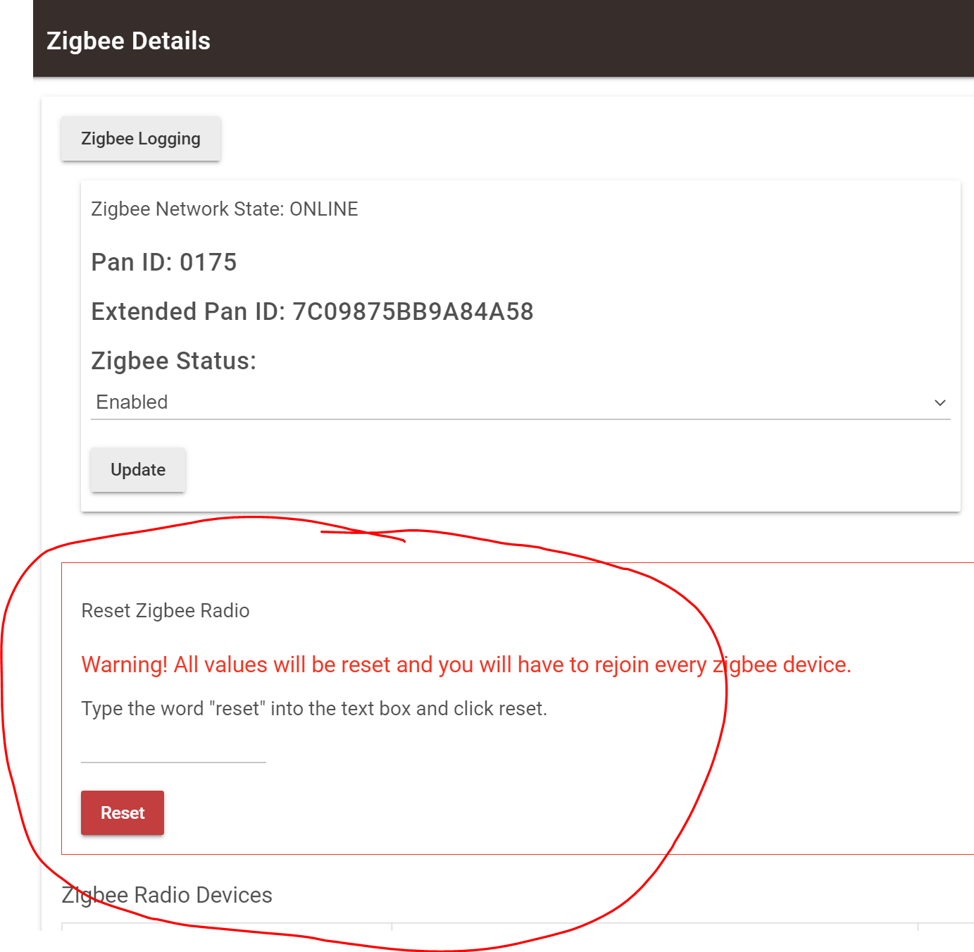

If you want to reset your hub without losing your registration of it you can do the following.
- Complete a soft reset.
- Settings -> zigbee -> reset. (This will 'factory' reset the zigbee radio).
- Settings -> z wave -> reset. (This will 'factory' reset the z-wave radio).
You will now have a clean hub without the full factory reset.
As @bobbles has mentioned, it is simple to reset the radios. Here is the Zigbee page.
