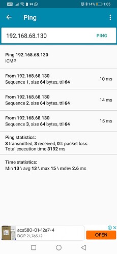

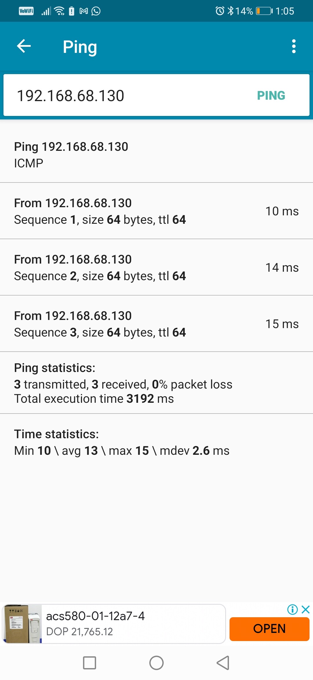

So you have set a fixed IP on the Hubitat hub.
Can you "ping" the hub from your router/gateway?
If so > getaway issue in hub.
If no > networking issue (could be settings ore cable)
To rule out the cable, just place another device on the cable and test.
I'll try this and let you know. Thanks
