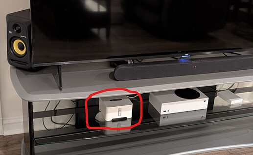

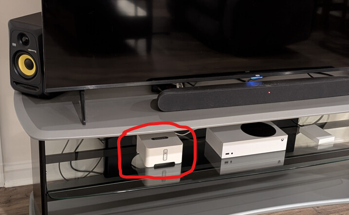

In my living room I have a Sonos connect amp connected to two KRK speakers. This does not show up in the Hubitat Amazon Echo skill. I asked AI about Hubitat and connect amp compatibility and here is Co-Pilot's response which I am doubtful:

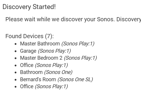

Yes I should have mentioned that. Sonos integration only works with my Sonos speakers, and does not detect my two connect amps:

Yes, I was just using it and playing music. Then I tried to detect it again while in use, but the Sonos Integration app still did not discover it. This is a 1st generation Sonos Connect about 10+ years old if I had to guess. Maybe the older models are incompatible?

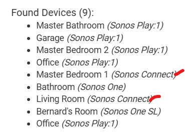

I finally got it. I cycled power to the Connect then within minutes ran the Sonos discovery again, and it found the connect! I didn't hold much hope for cycling power because power is cycled occasionally when we have power outages. I'll try the same thing with the Sonos Connect in the bedroom.
Thanks for your help with this.

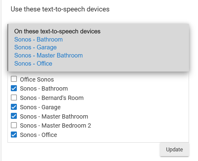

Looks like I popped the champagne too early. When I try to add the Sonos Connect to any rule the Sonos Connect devices are not available as an option:
But they were discovered. I tried rebooting the Hubitat but that didn't help. So close!
I don't have Sonos anymore as I've swapped the amps out for Wiim devices (no Apple Music integration - epic fail). However when I did have them they worked fine for text to speech with Hubitat's built in Sonos integration. The amps were very old and were bought as 'Zoneplayers'. They were the ZP100 and ZP120, the former being from about 2007 so your newer ones should certainly work without issue.
Were they just discovered, or did you complete the wizard to actually add them to your hub?
Duh! I didn't complete adding them by checking the check boxes. Thanks again for your help!
