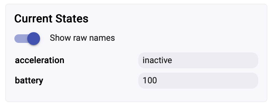

I just bought the THIRDREALITY Zigbee Vibration Sensor but it only does acceleration Active/inactive
(THIRDREALITY Zigbee Vibration Sensor, 110dB Alarm, Adjustable Sensitivity, Works with Echo, SmartThings, Home Assistant: Amazon.com: Industrial & Scientific)

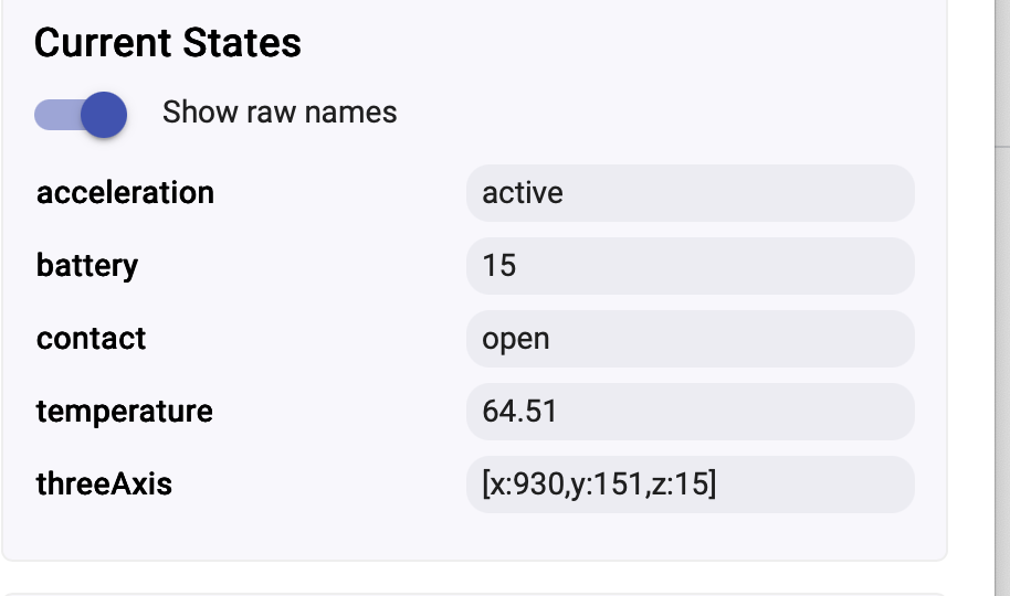

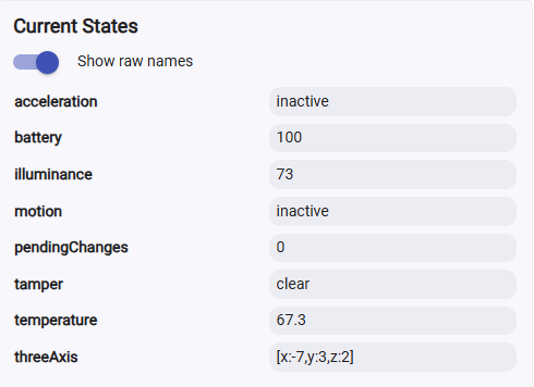

I have a couple of the Fibaro FGMS-001 Zwave Sensors:
fibaro_sensor
The Aeotec ZigBee multi-sensor is the same as the Smartthings device. I use one on my sump pump discharge line to track sump cycles based on vibration. Aeotec Zigbee Multipurpose Sensor (GP-AEOMPSUS) 810667025427| eBay
