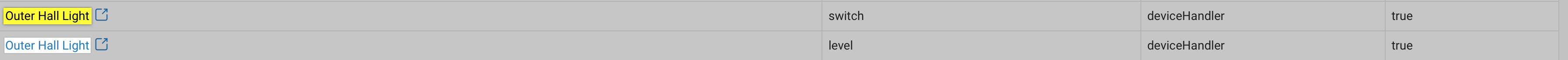

I have the previous generation of an Inovelli Red dimmer, the LZW31-SN that is named "Outer Hall Light". I had it in Hubitat and Alexa, but removed it by accident from my Hubitat Alexa Echo Skill. I went back into the Hubitat Alexa Echo Skill and re-added it as you see below. (BTW, I made sure to click the "Done" button and the screenshots below were all from after I went back into the Alexa Echo Skill app).

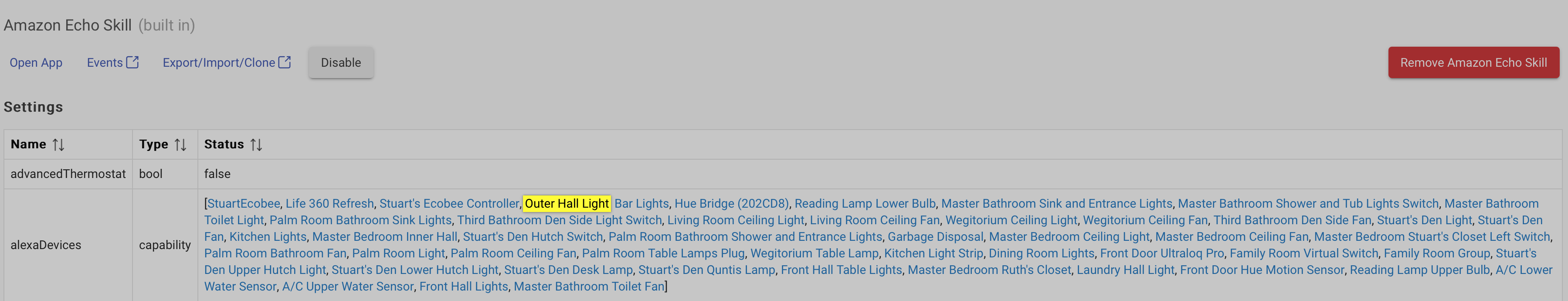

In the Settings screen for the Alexa Echo Skill it is also in the alexaDevices listing:

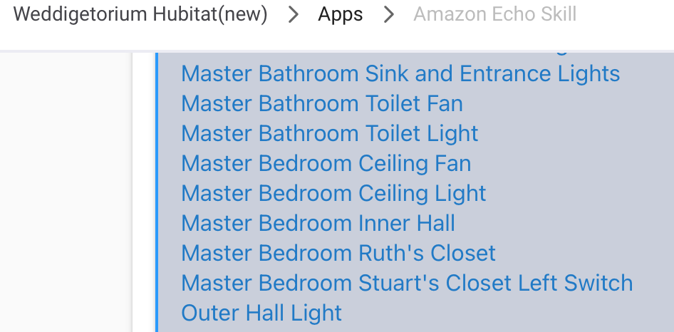

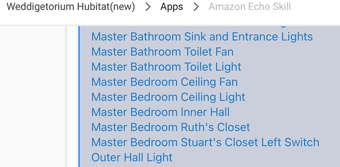

and in Event Subscriptions:
However, there is nothing listed under Events when I clicked Events from inside the Amazon Echo Skill settings:

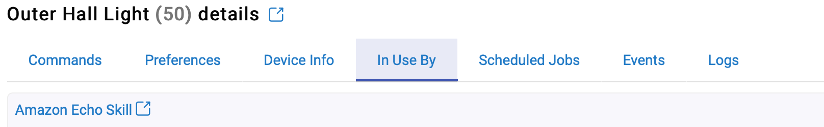

I went into the device itself and under In Use By it shows it is in the Hubitat Amazon Echo Skill:
