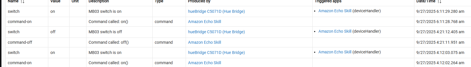

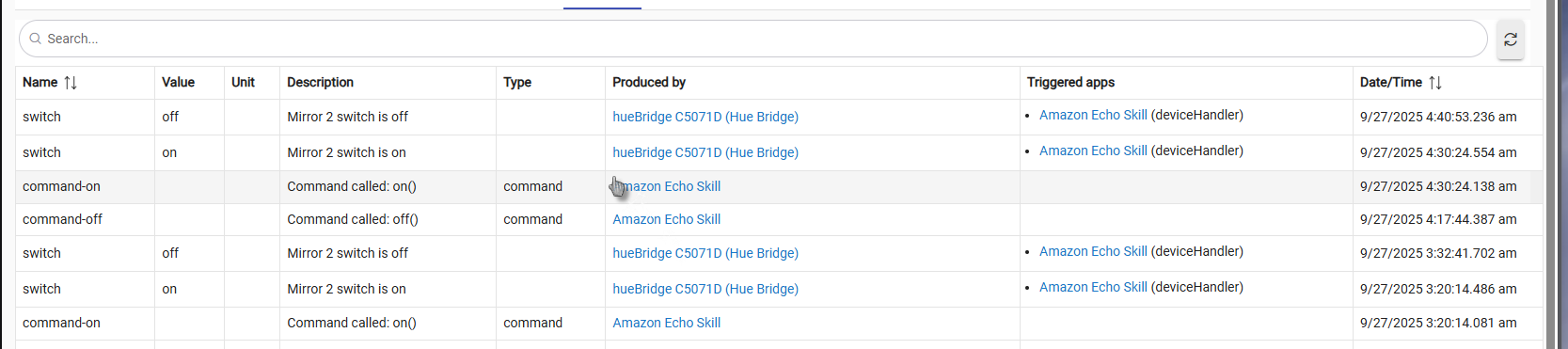

My Hubitat C-8 has been having issues with the Amazon Echo skill turning on hue lights randomly throughout the night. There are no calls to turn-on the lights in Alexa logs in the Alexa app being made, there are no routines, hunches are disabled, I am not running guard mode either. I have disabled ultrasound on devices that have it. I have removed and readded the Alexa skill. I have removed and readded coco hue integration and the built in integration to see if that would stop the issue. I am running the beta version of Hubitat as I am using the hue pro hub now. I am at my wits end on this and ready to chuck Hubitat out a window. I also use Alexa+ and haven't had this issue before, but it has been present since I upgraded to the beta to use the Hue Pro Hub. I also am including the logs of a recent light turning itself on overnight. It states the Amazon Echo Skill. Is there anything I should be looking for or doing?
Please advise.
As I finished this the bedroom lights just came on with noone in there. here is one of the lights logs

Your unexpected "on"s are definitely coming from Alexa, based on this, which was my hunch (no pun intended) there.
Disable the Hubitat skill and use Alexa support to figure out the issue. Your screenshot makes it clear that the command isn't originating on Hubitat.

Which logs? On the Hubitat side, there are definitely "on" commands originating from the Alexa skill, which means it would have been something coming from there.
