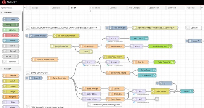

Node-Red flow (See Kick Dump.js)is kicked to regulate the Dump Load Dimmer switch.
var absdp = Math.abs(ShellyEM - DumpDeadBand);
DumpPower += (absdp * DumpPgain);
Solar Dump Power HTTP client 25-08-2025

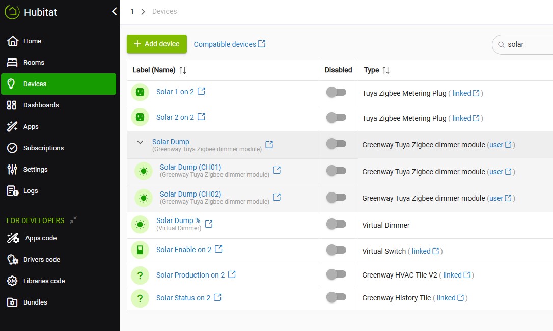

  • Two Hubitat Elevation C7 hubs

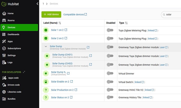

    You can see the hacked driver for the Zigbee Tuya Dimmer Hacked a Hubitat community driver by "Matt Hammond" to get it working with the _TZ3000_kvwrdf47 from AliExpress
  • eWeLink CUBE running Node-Red in Docker. Seems quite good at more math intensive cyclical workloads. Keeps Hubitat load low and more responsive.
  • Dual 100W channel dimmer both in parallel driving a 280W heat lamp. Stays perfectly cool at full power with heat sink added to Triac's
  • AliExpress part Tuya Dimmer Hacked a Hubitat community driver by "Matt Hammond" to get it working with the _TZ3000_kvwrdf47
    def cfg = [" _TZ3000_kvwrdf47": [ numEps: 2, joinName: "Tuya Zigbee 2-Gang Dimmer module" ]]
    See Greenway Tuya Zigbee dimmer module.groovy

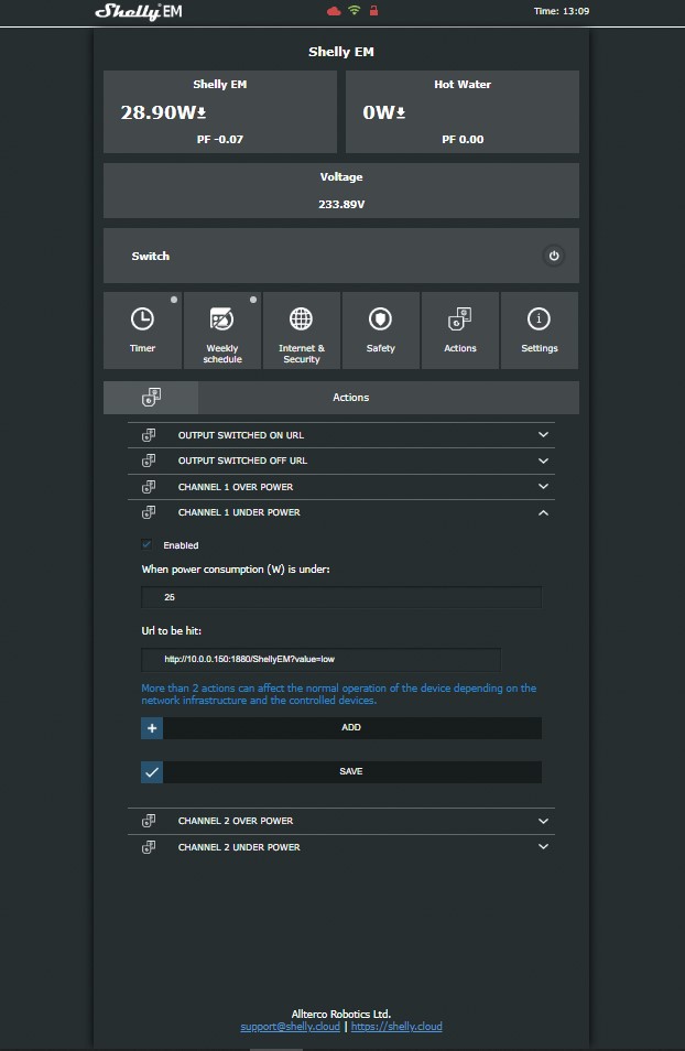

  • Stop solar export in low load situations, which does happen when the house is unoccupied

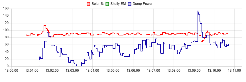

  • The 2 second update

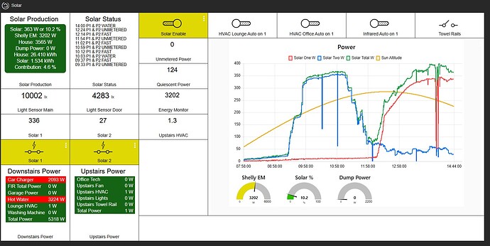

You can see below the dump load a $5 lamp regulates the load so I DON"T export hardly any power. While maintaining near peak solar utilization.
We produced 1.119kWh dumping 0.217kWh with a single panel generating 371 Watts so far today we have only exported 2.4 Watt out of 1.119kWh generated
