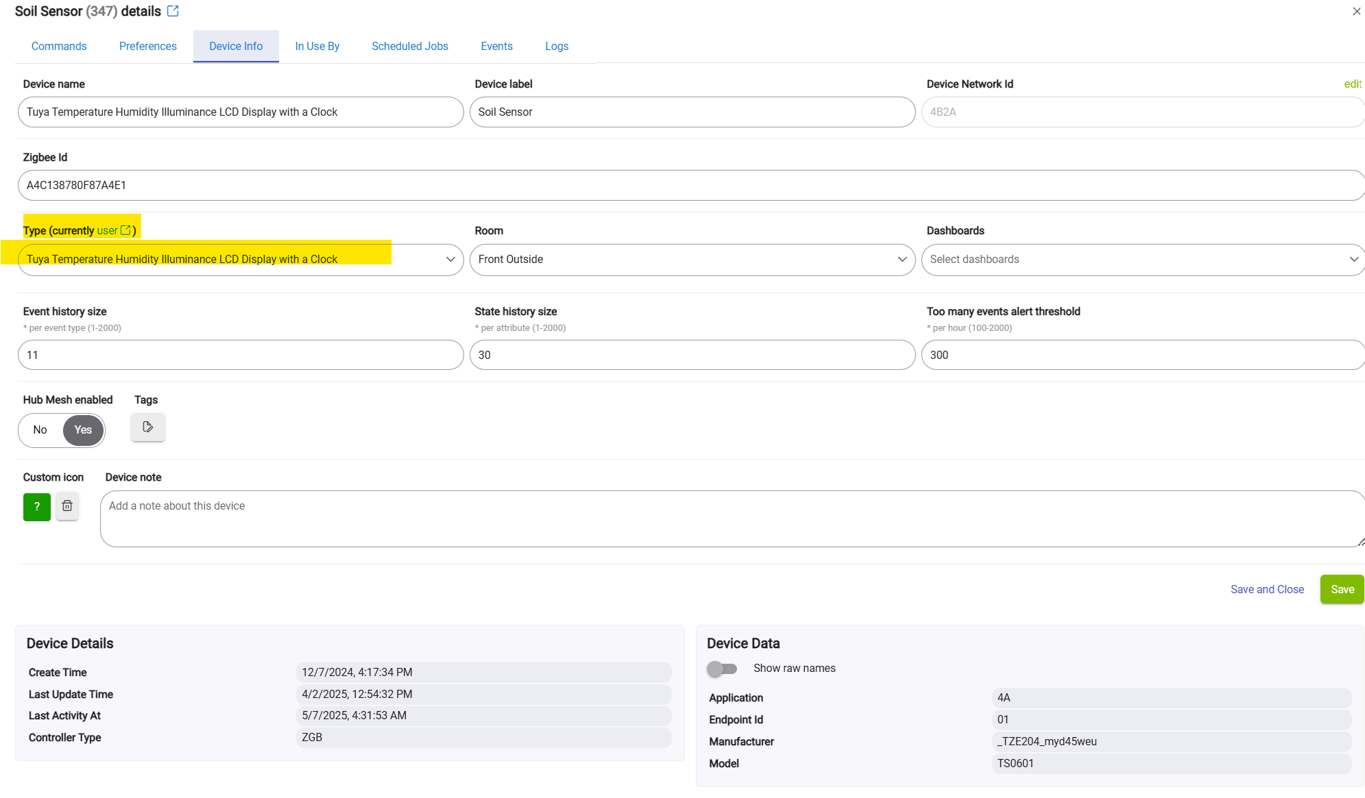

This one works well so far

Using kksov “Tuya temperature humidity illuminance lcd display with a clock” driver
That link appears to be the Tuya GMX-01, albeit very expensive. Amazon sells them 2 for US$45. The question is: is there a driver for Hubitat? Specifically, the C7 for me...
Are you saying you use the Hubitat driver for the Tuya indoor device?
Driver i am using is:
And it just works, well? Any issues with pairing?
