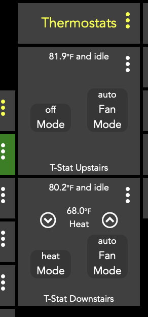

As I initially said, you don't get many choices off the dashboard:
The temp up and down arrows are only good 'til the next thermostat change.

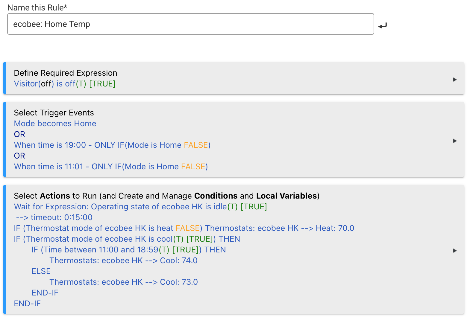

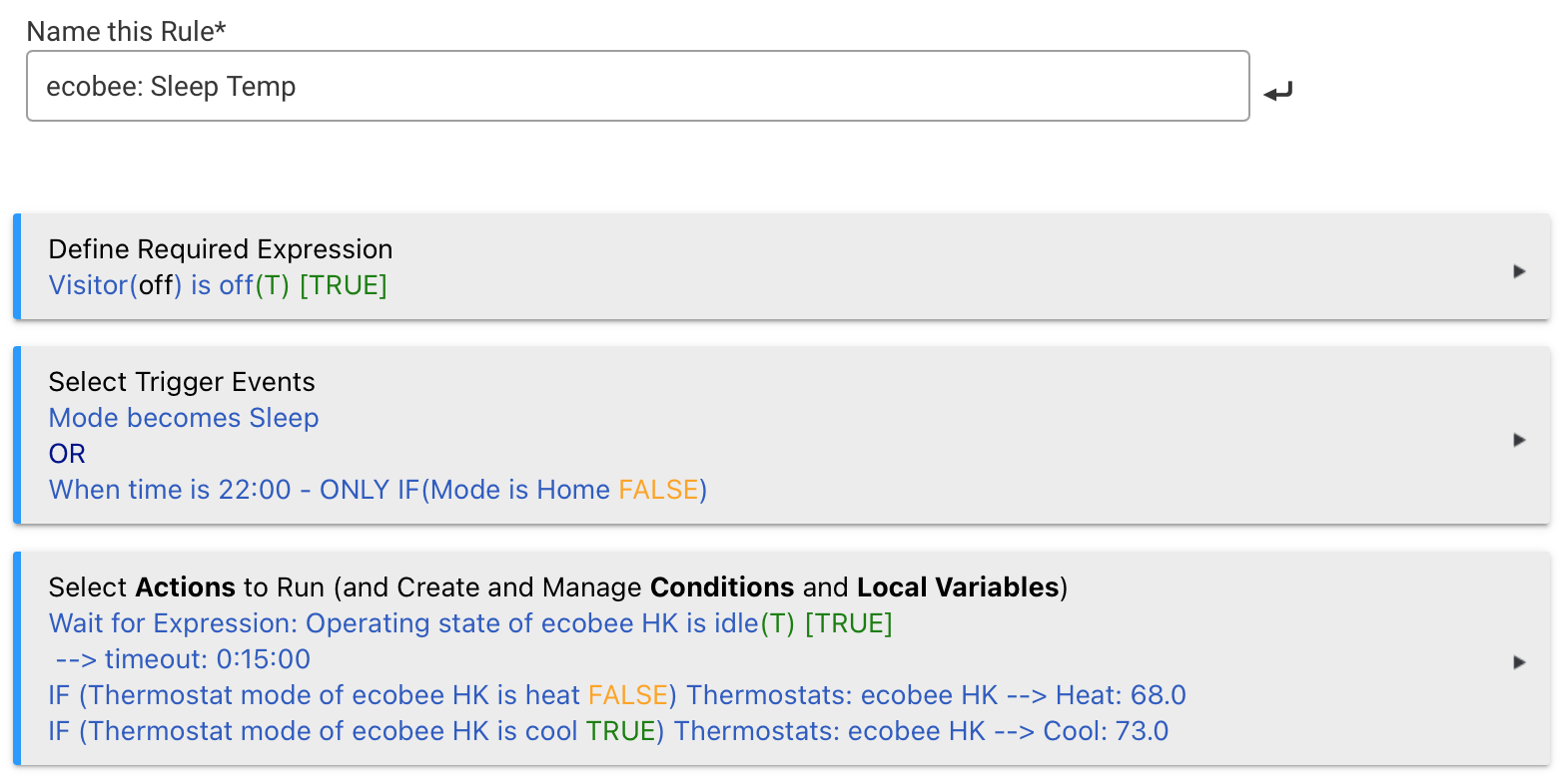

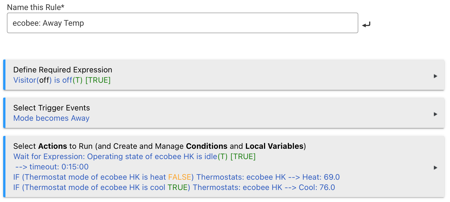

I have been using my ecobee locally for some time, via Home Assistant's homekit device integration, which is then exported to HE using HADB.
I no longer use ecobee schedules. Rather, I use changes in mode, with some schedules, to set the temperature through three rules. Here are the rules:
Home Mode:
Away Mode:
Sleep Mode:
I use a fourth rule to determine whether the thermostat is in heating/cooling mode based on the outdoor temperature.
