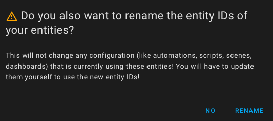

There's some other big issues that drove me away from HA, but the ridiculous amount of pain a simple entity_id rename can cause is probably the biggest peeve I have with it. Sure, renaming one entity_id isn't a big deal, until you realize that a busy HA instance might have a couple thousand entity_ids. And worse, sometimes a single action can rename a hundred entity_ids. In HA if you rename a "Device", it'll ask if you want to rename all the associated entity_ids, and if you click on "Yes", then it can break all sorts of stuff:
Screenshot 2023-12-19 at 13.23.12
Seriously. This is just stupid, annoying, and shouldn't even be something that causes friction, let alone pain.
