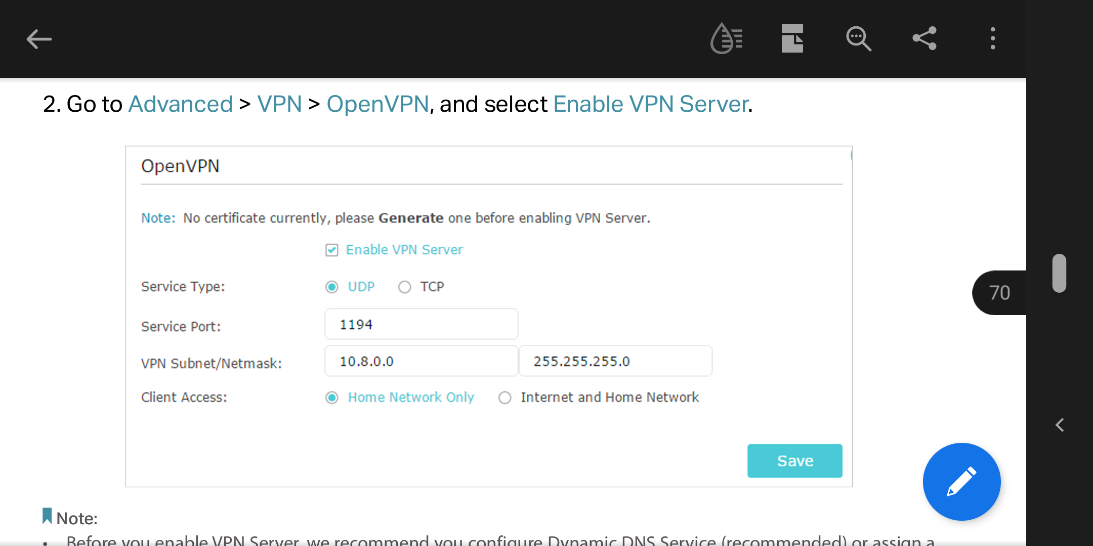

You need to select "internet and home access" in your setting to be able to access your home devices.
I tried it both ways. Couldn't get either to work.
