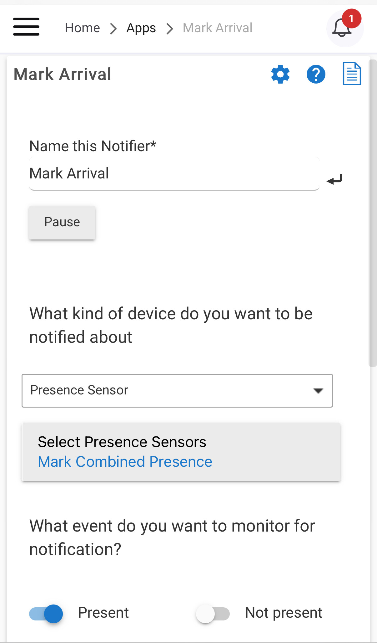

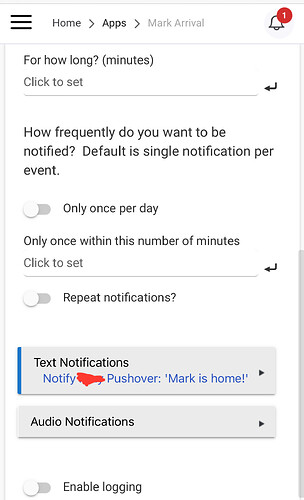

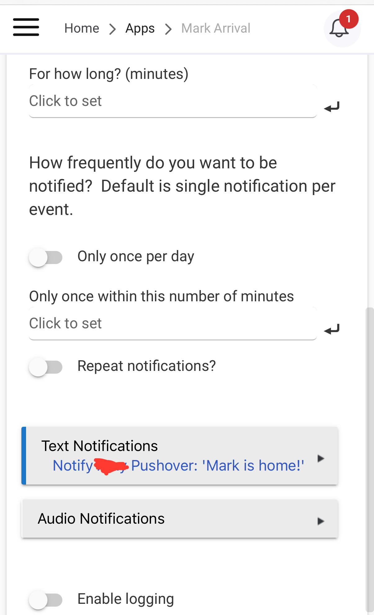

Here’s an example of a pushover push notification I configured with the Notifications app.
I could create a similar notification and select my iPhone running the Hubitat mobile app as the device to push a notification to, if I wanted to.

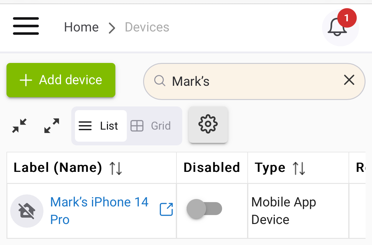

But when you login to the mobile app on your phone, the hub should create a virtual device that serves the purpose of both presence sensor and push notification recipient.
Do you have a virtual device that represents the phone the mobile app is installed on, in the hub’s list of devices?

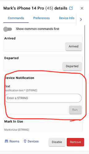

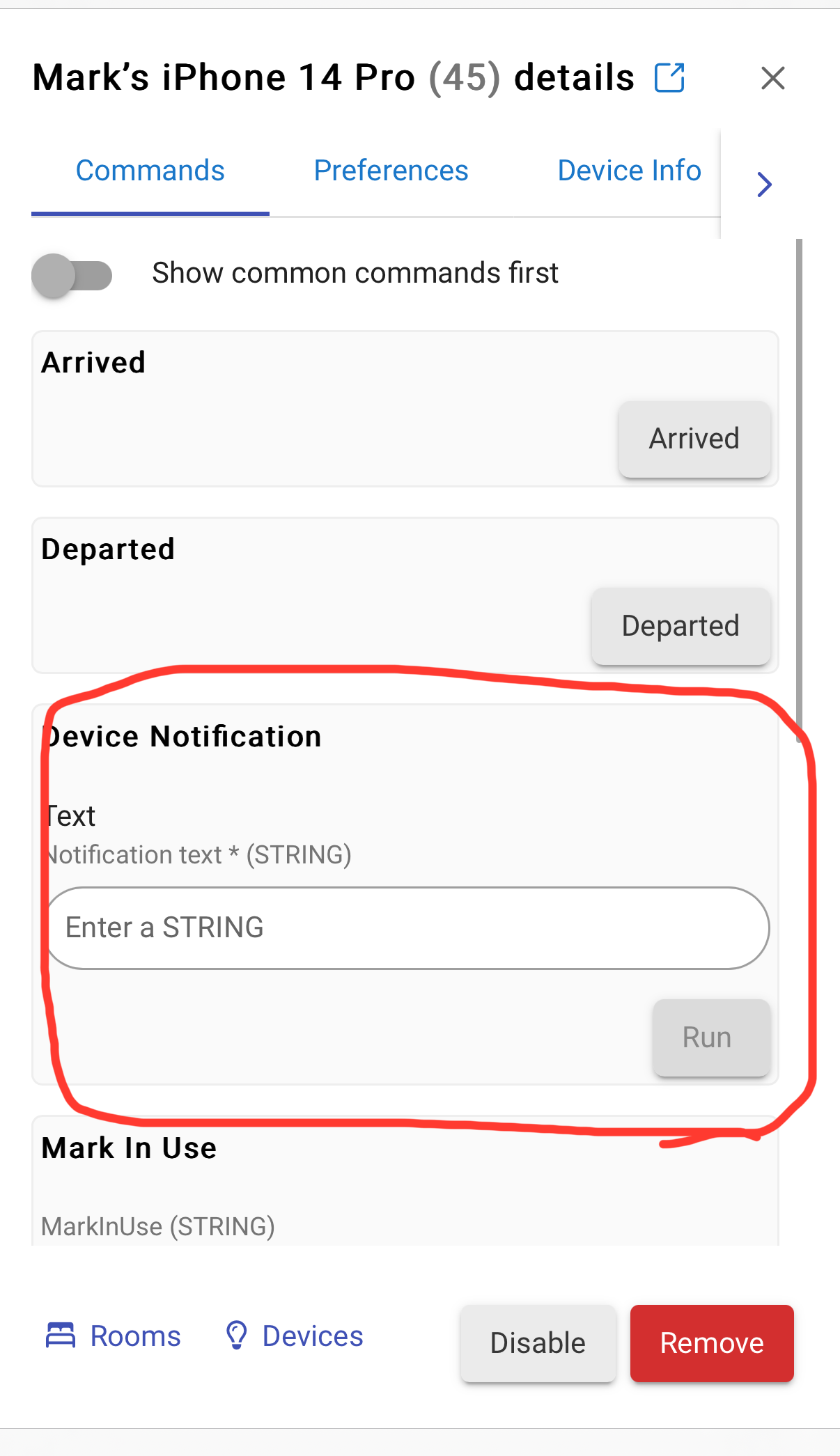

This is mine, for example:
When I click on the device details page, I can send a test notification to the device manually, to confirm the connection is currently working.
Please confirm that you can do the same with your mobile app device on your hub.
My phone has the app, is listed as a device, is present, and I can send a test to it.

Yeah, I'm an idiot!
At some point I added the option to repeat the alert several times and mistakenly entered 1 in the field labeled "For how long? (minutes)". It was working, it just that is was set to wait 1 minute before alerting. I've set it to 0 (zero) and it now alerts immediately.
