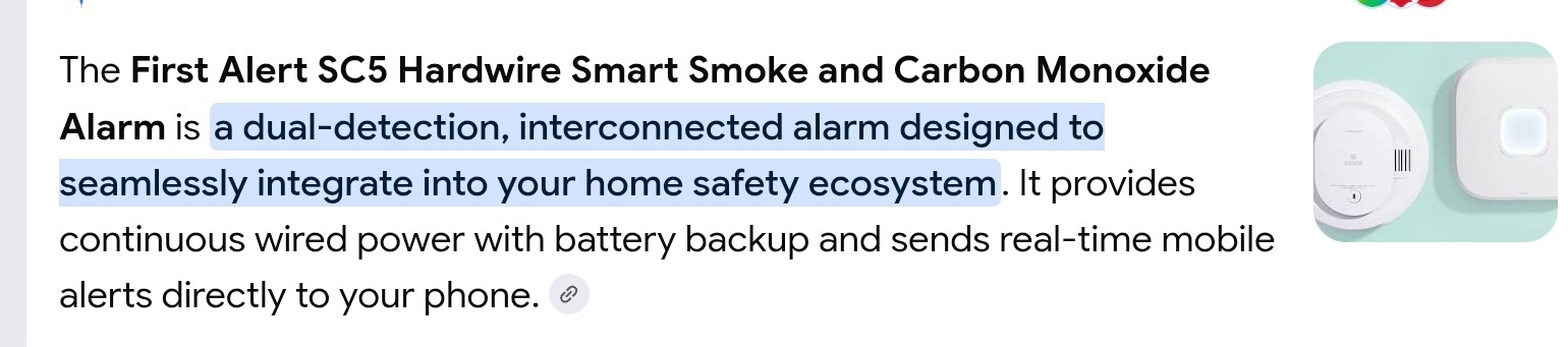

Thanks! Wish they weren’t First Alert, but I’ve got until 2027 to hear from others on how reliable they are, and how well the false alarm prevention works. If they are interconnected and work with Nest Protect, I’m assuming I would not need Ecolink firefighter since I have both the Home Assistant Nest Protect integration and the Starling hub (still works with Apple Home).

2- First alert also has wired AND smart. But based on reviews about battery alerts, I am not sure they are the best choice. I am hoping by next year when mine expire, there might be some better options.

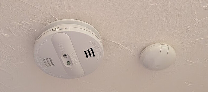

No extra wiring needed with the EcoLink Firefighter. Here is mine (on the right) next to my wired, interconnected smoke alarm. If any alarm in the house goes off, then I get an immediate notification.
I guess my mistake is assuming everyone's alarms are interconnected. If they aren't, then you need one EcoLink Firefighter per smoke alarm. That is suboptimal.
